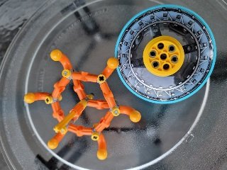

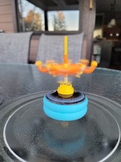

Yes, it's all about angular momentum transfer through the pivot bearing friction between carrier and rider. If you started the carrier in one direction and then the rider in the opposite direction, the rider would slow and fall before reversing speed, as it needs a certain critical spin rate to stand against gravity, regardless of spin direction. That critical speed is the same whether the rider's on the carrier or on the ground. Doubt a 2nd rider would stay seated long. A rider with even half the carrier's mass would probably be too heavy to carry, but this is a complicated question involving moments of inertia and launch speeds.
- 11 replies

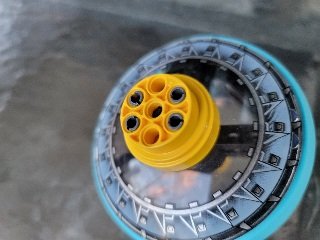

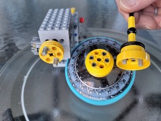

The only thing better than one long-spinning LEGO top to play with is another stacked on top of it... Both tops are based on Spike wheels with dish fairings to reduce air resistance, the main cause of spin decay. The lower "carrier" must have a large axial moment of inertia and a high launch speed to make the upper "rider" this easy to launch by hand and this tolerant of knocks and manipulation. After video above, fitted the carrier with a permanent rider mount greatly improving ease of use and therefore play value. The starter (below left) and detaching stem (right) for finger play now engage the carrier through a 2-pronged drop-out dog clutch. Many other rider designs work, but rider weight can be neither too heavy nor too light. Purist alert: Fine black carrier tip cut from 4L antenna.
- 11 replies
