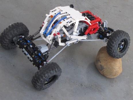

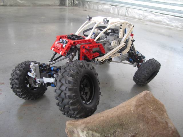

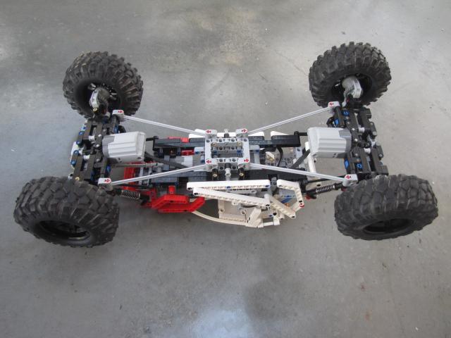

MOC 4x4 Rock Bouncer
sacm93 replied to sacm93's topic in LEGO Technic, Mindstorms, Model Team and Scale Modeling
Thanks JJ2, but I'm afraid that's one thing SevenStuds shared with me before he published his crawler. We actually corresponded together for a while regarding various building techniques, he was a great help to me. It actually has quite a lot of torque. The AA battery box can supply up to 9 volts rather than the 7.4 volts supplied by the Li-Po battery box which enhances motor performance while the added weight of the AA box assists traction. The major limiting factor is really just the flexibility of the lower arms. Knob wheels were used to transmit torque from motors to along the axles, so teeth skipping was not an issue. I did. It looked ugly in my opinion and added certain other suspension-related limitations. I really wanted to set and achieve the goal of having some kind of shaft working properly alongside the suspension links. Backlash is moderate but actually surprisingly workable. I found having drive on the front axle helps the wheels the "claw" their way over obstacles instead of being "pushed aside" (if that makes sense).- 6 replies

G'day from Australia everyone! This is my first topic created on Eurobricks and my first serious MOC since the end of my "dark age". I'm seriously super glad to be here and keen to share my Technic creations with you all from now onward. With this in mind, if there's any way I can improve how/what I post, by all means let me know so I can keep everyone (including staff) content. I am committed to giving this site the full respect it deserves. :) As a few of you have suggested, it's a good idea when coming out of your dark age to develop designing/building skill by drawing on other people's MOCs for inspiration and guidance for different building techniques... Partially inspired by SevenStuds' recreation of Tim Cameron's rock bouncer "Showtime", I present my own 4x4 Rock Bouncer. Features.. Drive: 2 PF XL motors (1 per axle). Final ratio is 3:1. Steering: 1 PF Servo motor with rack and pinion Suspension/axles: Full-time locked solid live axles with portal hubs (geared 3:1), suspended by 9.5L shock absorber (soft) (2 per axle) and stabilized by a double triangulated four-link setup. Tires: Third party scale RC tires similar to the "Rock Crusher" by RC4WD. Battery: 1 x PF AA battery box Receiver: 1 x PF V2 I initially began designing some kind of rock crawler which was to include PF XL motors, third party tires of some description and (after quite a while researching suspension design) double triangulated four-link suspension. This kind of suspension is ideal as it provides maximum articulation and strength of the axle while eliminating the requirement for a Panhard Bar or Watts Linkage because the triangular positioning of the upper and lower control arms oppose each other, eliminating sway and allowing all desirable movement. By far the most difficult part of designing was the requirement for a steering shaft which moved harmoniously with the suspension cycle of the front axle. Because the upper control arms are shorter than the lower ones, the angle of the axle relative to the chassis changes through it's cycle and this means that when positioning the steering shaft, it must be such that the radius of it's motion doesn't change (due to angle change) as TLG doesn't offer any part which works purposely as a slip joint to negotiate the effect of plunge. After many, many, many... many attempts, a sweet spot was discovered which offered a negligible discrepancy. (This was a happy moment). It's biggest performance drawback would have to be that when the angle of climb and drive torque applied is too great, the rear lower control arms buckle and the rear axle begins to walk under the chassis. Trust me, it's cringe-worthy. With 15L beams instead of 16L links and consequently different suspension geometry, however, this could be resolved. The turning circle also suffers due to the wheel base. Overall, I am reasonably happy with the final product as it is capable of most of the things I intended it to be and in my opinion, the body could look worse. ;) I unfortunately don't have video footage, but I do have photos (see below). Enjoy! All comments welcome. :D

From personal experience, when building a double triangulated four-link setup, it's a whole lot easier to build using upper and lower links of: -The same length, -The same angles outward from the longitudinal axis of the vehicle, and -The same length as the drive shaft and/or steering shaft running from the chassis to the axle. Having said this, however, one can achieve a more authentic visual and behavioral effect by using shorter upper links than lower (a good ratio is upper=60% of lower length). One would think that doing this would make it impossible to include drive/ steering shafts (because the very characteristic that this design is aimed at achieving requires the use of a plunging drive/steering shaft; one that uses a sleeve to change length through the cycle of the suspension) however I have found that there is a "sweet spot" where you can position the shaft(s) such that they travel along an independent arc where the axle cycles through the suspension so that the distance between the drive/steering output at the chassis and the input at the axle remains the same throughout the entire suspension cycle, or at least enough of the cycle for a reasonably sized shock absorber (9.5L) to be then built into the design. As soon as I have permissions, I will upload my "Rock Bouncer" MOC to illustrate the above concept. I used 16L lower links and 9L uppers. :) I hope this helps anyone looking to build their own crawler/4x4/bouncer type buggy as I know they're a popular concept.
