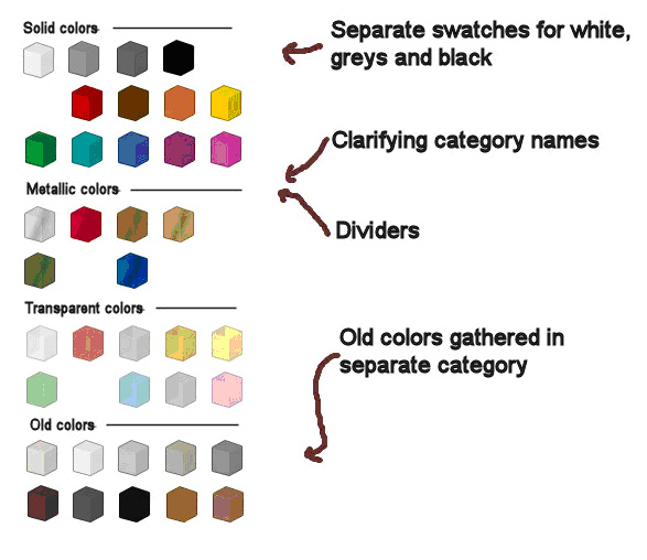

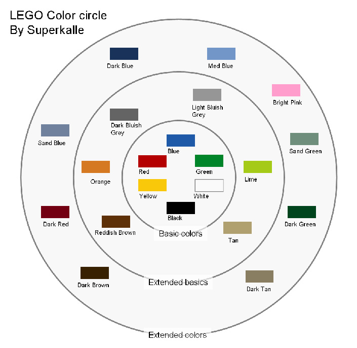

  11. Interesting points guys. @Aanchir, I see your point about defining what is "old colors". I guess I was thinking colors that haven't been used the past 5 years (or something like that). The reason is twofold: 1) avoid the most common colors (mixing old greys and brown with the new ones) and 2) make the list of colors small. I guess one could put the question like this: Which colors ought to have their own swatches "up front" and which can be burried one level down (i.e. used less frequently). I've been playing with this concept of a color circle, with the most important colors in the center. So far only solid colors, but it looks something like this:

  15. OK everyone. I think the Color palette in LDD 4.0 is really bad. First it mixes old and new colors, as well as colors that aren't even used for bricks (at least so it seems). Then it's annoying that very common colors such as Black, doesn't have it's own color swatch. And to top it off, it's a nuicance to have to click first on the Bucket icon, then on the color swatch and THEN on the color. It should be faster to reach the color palette. So, how should it work instead. What kind of setup do we want for future versions of LDD? What colors would be good to have "shortcuts to", and which should be in the "expand" window? To start off with, below is one idea of new layout I've been playing around with. But is it too lame, do we need a more radical change in coloring feature?
