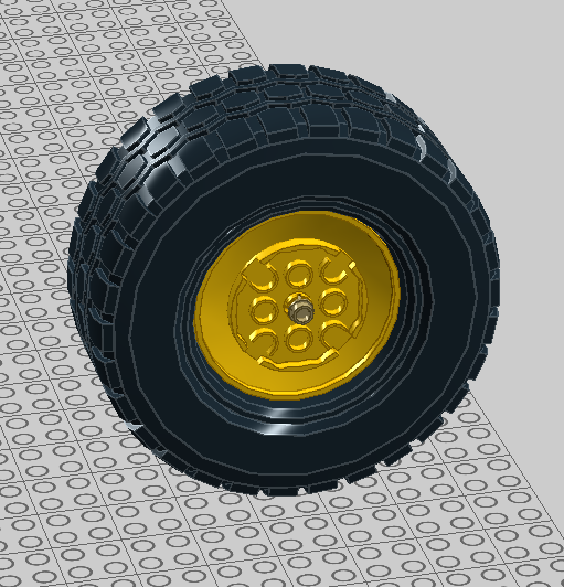

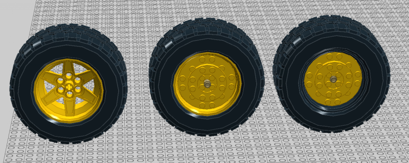

Yeah, you're right - those don't exist in yellow. But I suppose 44375 Dish could be used then....or something else?
A MOC solution for the tires could be to use black rims with a yellow center cap. That would give the illusion that the tires has higher profile. Three examples, from left to right 1) Original 2) Yellow rim, yellow center 3) Black rim, yellow center
