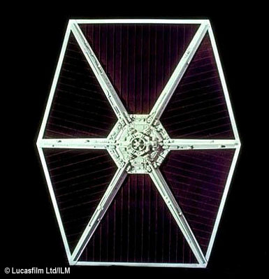

I haven't seen this before, but there are a few things I noticed straight off.
Is there any particular reason you've got the cannons kind of hanging off of the ball cockpit like that? Because the guns on the studio model are much closer to the windshield (though not so much that they break the circle of the windscreen like the ones on the LEGO set).
The wing pylons should be a bit thinner where they meet the panel; however, you've got them widening out again. Is this a structural issue? Because I think that a Technic axle running all way through the other side of the wing would do the trick (not unlike what LEGO did on the 10174 UCS AT-ST).
Nice work on the new wings. To be honest I was a bit skeptical on the wings myself until I saw this picture. I guess I'm too used to the 6x12 wings that LEGO uses for their TIEs to notice that 1x4 wings capture the angle more accurately (not unlike the wings on the X-wing - coincidence?).
Where are the ion engines and the rear window?

I see from the new picture that part of the wing is three plates thick, which I think would be enough for a Technic axle. And you could also switch the large wedge pieces on the front and back of the wing pylons with 1x3 33 slope bricks to make the pylons appear thinner, as it does not look like they offer any structural support.
The two red dots and the hexagon-shaped hole seen in this shot of the studio model. In-universe, the red points are the Twin Ion Engines, and the hexagonal hole is a rear viewport. I saw that they were absent on your model.
