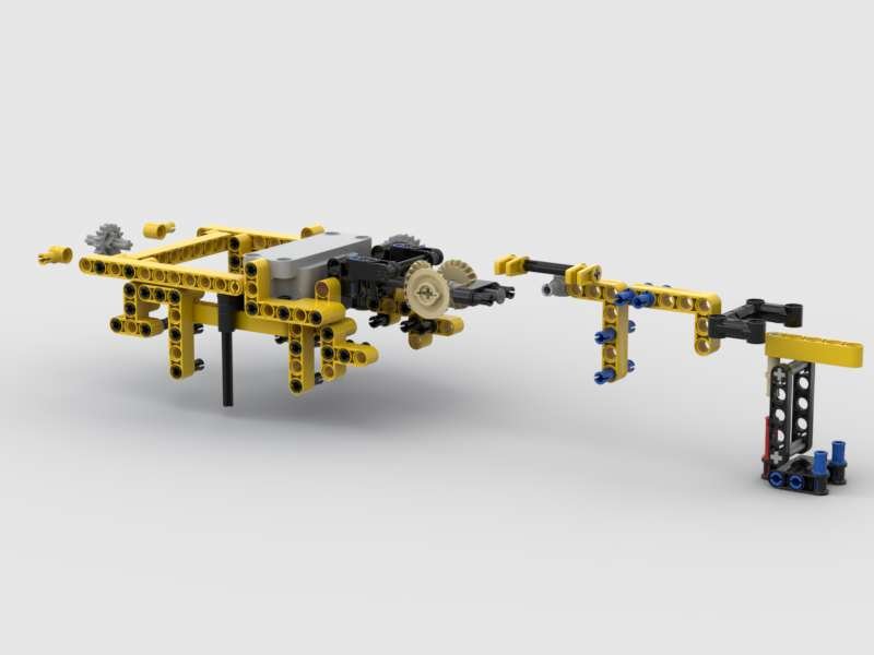

Hi, I am building the Liebherr R9800 MOC of Efferman. On page 19 of the manual the battery box is assembled. When mounted in the rest of the chassis it is not supported at the back. The black pin is there but doesn't get in anywhere. Or am I missing something. I solved it with as on the pictures. They may have forgotten to put this in the manual.

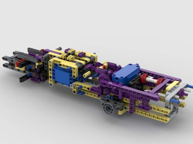

Hi, After about 20 years of not building a Lego set, I started working on it again. After the daughters had put some Lego Friends sets together I had to do this. Recently I built this Volvo A60H and I wouldn't be me if I had to change anything. I don't like the use of the Lego Control+ app. That is why I use theeBricklink2 app to control the Volvo. I didn't like the idea of using the gearbox to control the tipper. That's why I built in an extra L-engine to drive it directly. In attachment some renders of my conversion/adjustments. The necessary parts are on their way and as soon as they are there the final modification will be done. I also did the Efferman upgrade of the articulation/steering. In Studio I did all the extra pieces that were needed in purple to see a good difference between the original pieces of the set.
