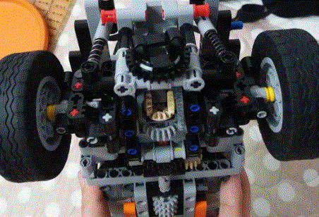

  10. Hello doggo, I am so busy try to find a photo store website what we can use. I post some picture:
  11. Up date my photo, sorry not clear because of attach size limited.
  12. Hi DOGGO, SORRY , I forgot take a front picture, let me make a explanation first, any update new picture later. maybe 8 hours later. the front ALEX based on 5x7 frame, left and right is wheel, front and back install small turnable, and middle is Differential. my problem is how to arrange the servo motor? the best way I thought is put the motor on 5x7 frame, so it can swing with front alex. But with 1x7 gear rack , I really can fix the Z12 at two side, so the z12 gear and rack always separate each other. maybe it is possible install the motor on truck upper fame? use universal joint connect. because the upper fame have space.
  13. Dear all, Sorry post first SOS topic, i try to building my first MOC truck, it is 6x6 with 20unit WIDE ,62.4x20 wheel. I meet a strong problem about the truck suspension: I did not know it's basic rule My front alex is pendular suspension, the alex with two small turnable,but how to arrange the steering motor is really painful question. My back alex as picture showed, it looks really stupid and strange..I have a lego 42043, but i really didn't just get a new copy.. I read ALEX connection topic, but there is not many truck suspension. Could any body give me some suggestion? many many thanks!
