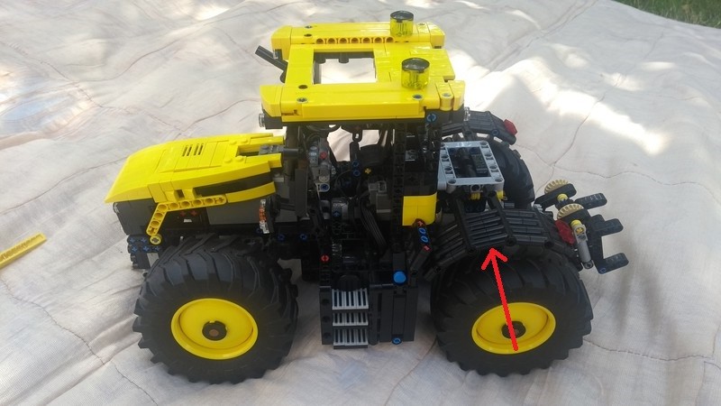

Since it turned out that proper line is very very hard to achieve without holes, I have another try but it is not finished due to missing some parts (which will arrive until mid of July). I use older bonnet as comparison with latest...any comments is appreciated...

On 7/13/2020 at 8:41 PM, Jundis said:
What exact type of Fastrac do you try to MOC?
4000 series ...sorry for (very) late response but I work on 5 LEGO projects at the moment...
@eric trax I think I have made the most acceptable compromise solution for bonnet. I hope for better weather tomorrow to make better photos ... I hope you like it. (To many "I" :wink:)
(My Calico cat is very often in the way...)
Front bonnet is just one plate height to high.
Is it the final effect? I think the mask needs more slope to move, especially the grill and exterior light. Now it seems little bit flat.
It is a pity that there is such a small selection of yellow wedge bricks
The rear fenders should be a stud longer;)
Middle part of bonnet is a bit to flat (when I compare it to print from manual that I have it us about 1.5mm to low in the middle)...I do not understand completely what you mean about more slope on front mask?
Rear fenders could be one stud longer (at the back) but it would end up to flat perhaps...
Thanks for tips buddy
Yes we have to limited choice with yellow slopes.
When I look at images that I have (tomorrow I'll look at AGCO seller who has real Fastrac 4220 for display) it looks actually as a straight line (so I'll have to use black tiles) and not curved...so I think I can cover front positioned M-motor that drives front PTO
I think the mask is now much better
The cause of problem is that I can not make solution where "seat" panel and served slope plate would be on-line
Share this post
Link to post
Share on other sites
Much better Igor !! My next two suggestions:
- Place the pins and 1x4 tiles in the blue place.
- In the red place, insert the yellow wedge. It will be nicely rounded and a plate step will imitate the slope of the original hood
Another last suggestion. Please enter the stud length I mentioned for the rear fenders here. This will not affect the fender's curvature optically.

@eric trax this part https://www.bricklink.com/v2/catalog/catalogitem.page?P=29120&idColor=85#T=S&C=3&O={"color":3,"loc":"HR","iconly":0}
is not on sale in Croatia, but Audi Quattro set is available so I could buy this set...
Front part to be covered with tile 1 x 4 is possible but before that I'm working on rear fender on exactly the same place that you suggested with 2 axles 3 and 2 liftarms 1 x 4 on each side...
Thanks
