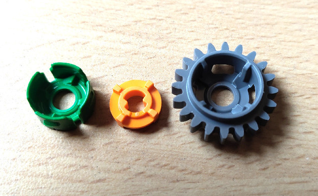

COPERNICON Posted June 4 Posted June 4 does someone have/knows pictures of how the freewheel/oneway gear looks on the inside? Quote

Stereo Posted June 5 Posted June 5 On 6/4/2026 at 2:52 AM, COPERNICON said: does someone have/knows pictures of how the freewheel/oneway gear looks on the inside? https://ibb.co/0p5Rt3B6 Someone shared pictures on Discord - the orange piece slides freely back and forth and alternating ramps catch it as it advances. No springs. Quote
SNIPE Posted June 5 Posted June 5 3 hours ago, Stereo said: https://ibb.co/0p5Rt3B6 Someome shared pictures on Discord - the orange piece slides freely back and forth and alternating ramps catch it as it advances. No springs. I wonder if its possible to take this gear apart in a non destructive way Quote
Auroralampinen Posted June 5 Posted June 5 6 minutes ago, SNIPE said: I wonder if its possible to take this gear apart in a non destructive way I don't think that was that destructive. The PF motors used a plastic pegs to hold them in place and i strongly think this uses plastic pegs too. I don't think lego uses plastic welding on these to permanently shut them in place Quote
HorcikDesigns Posted June 6 Posted June 6 Definitely a pegs, welding it would be too expensive. Quote
aeh5040 Posted June 6 Posted June 6 17 hours ago, Stereo said: https://ibb.co/0p5Rt3B6 Someone shared pictures on Discord - the orange piece slides freely back and forth and alternating ramps catch it as it advances. No springs. I'm quite surprised that this design seems to work so well. I do wonder how long it will last under heavy use. Quote
Davidz90 Posted June 6 Posted June 6 7 minutes ago, aeh5040 said: I'm quite surprised that this design seems to work so well. I do wonder how long it will last under heavy use Probably longer than a spring-based solution. It can only fail by ramps shearing off/grinding down over time, and they seem to be almost as bulky as regular teeth. This is an excellent design. Quote
Stereo Posted June 6 Posted June 6 If you loaded it heavily with a geartrain, it's probably going to wear the axle it's running on first (and the gear where it contacts that axle, which I expect is the green/grey pinhole, but that has more wear area than the axle's 4 ridges). Whenever it's freewheeling, the orange piece is almost entirely unloaded. The one thing I might change for an 'ideal' design is go slightly past 90° on the engagement faces of the ramps, so if the orange part is somewhere in the middle, it'll be pushed towards full engagement. But that's a more challenging shape to mold. If it does "skip" the first tooth it meets, it'll have full engagement on the next one. Quote
Timewhatistime Posted June 6 Posted June 6 The orange thingy's axle hole looks as if a crossaxle can be slided back and forth through it (like in the old worm gear or in the red 8t gear). Can someone please confirm (or rebut) my assumption? Quote
SNIPE Posted June 6 Posted June 6 1 hour ago, Timewhatistime said: The orange thingy's axle hole looks as if a crossaxle can be slided back and forth through it (like in the old worm gear or in the red 8t gear). Can someone please confirm (or rebut) my assumption? yes, there's just about enough room also, for 0.5L center stops which certain axles have (e.g 5.5L ,4.5L , cv joint female. Quote
aeh5040 Posted June 7 Posted June 7 4 hours ago, Timewhatistime said: The orange thingy's axle hole looks as if a crossaxle can be slided back and forth through it (like in the old worm gear or in the red 8t gear). Can someone please confirm (or rebut) my assumption? Yes, that's right. The whole thing slides on the axle frictionlessly. This seems to be necessary given the design. 14 hours ago, Davidz90 said: Probably longer than a spring-based solution. It can only fail by ramps shearing off/grinding down over time, and they seem to be almost as bulky as regular teeth. This is an excellent design. It's certainly a clever design, but I'm not so sure about longevity. I can imagine that the centre piece is constantly nipping at the tips of the wedges when freewheeling, and could wear them down quite quickly, which would lead to it not engaging reliably in the other direction. Anyway, we'll find out soon enough! Quote
