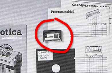

  8. hello, i have archived the educaboek's lego lines software some time ago, i have an almost complete educaboek book set (see this: http://www.miniland.nl/Dacta/). i have been talking with @amine about it on discord, i have archived most books of the set, i only need to do the student manual (i dont have an appropriate scanner for it...yet). the only thing i am missing from the educaboek set is this odd piece: you can find the scans here: https://archive.org/details/educaboek-robotica-nl everything is in dutch though....
