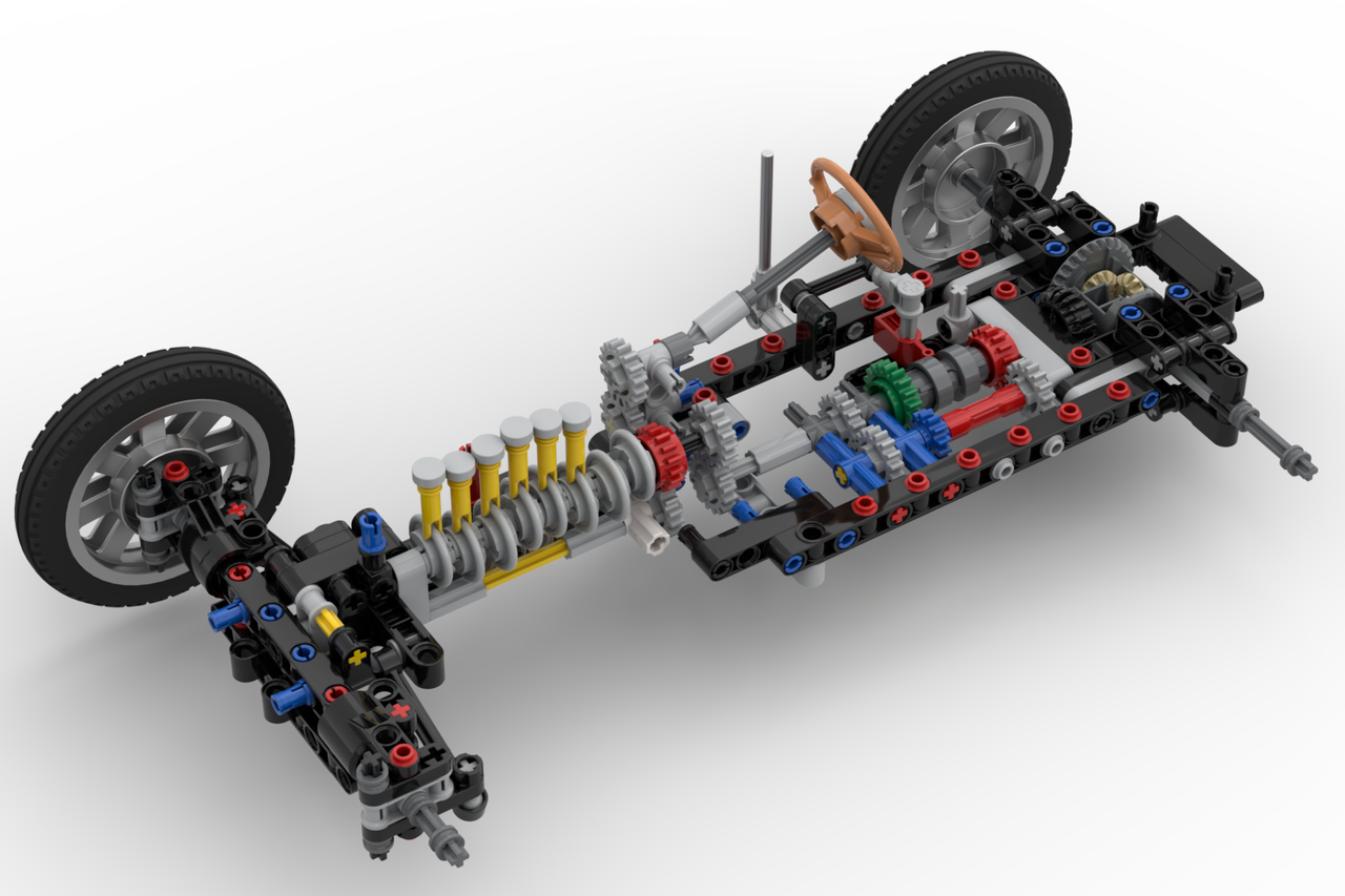

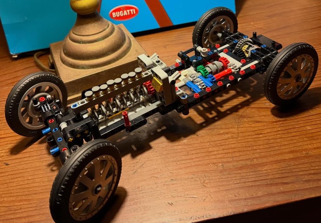

Stereo Posted Wednesday at 11:36 PM Posted Wednesday at 11:36 PM More likely guess to me is that 16t behind the engine is part of the steering, as is the axle under it, and the engine has another pair of 16t gears under the dashboard. The clutch gears and those engine discs don't interact at all, same end profile as axle-connectors that get used between clutch gears to hold the shift ring. Quote
Shiva Posted Thursday at 12:59 AM Posted Thursday at 12:59 AM 3 hours ago, R0Sch said: And somebody is actually building it. Fingers crossed for an instruction scan. https://www.instagram.com/p/DaUSVFUljSU/ I read your post as if someone was reverseengineering building it. Oops, I did read wrong. rheaultboats, is one of the lucky ones to get the actual set :) Quote

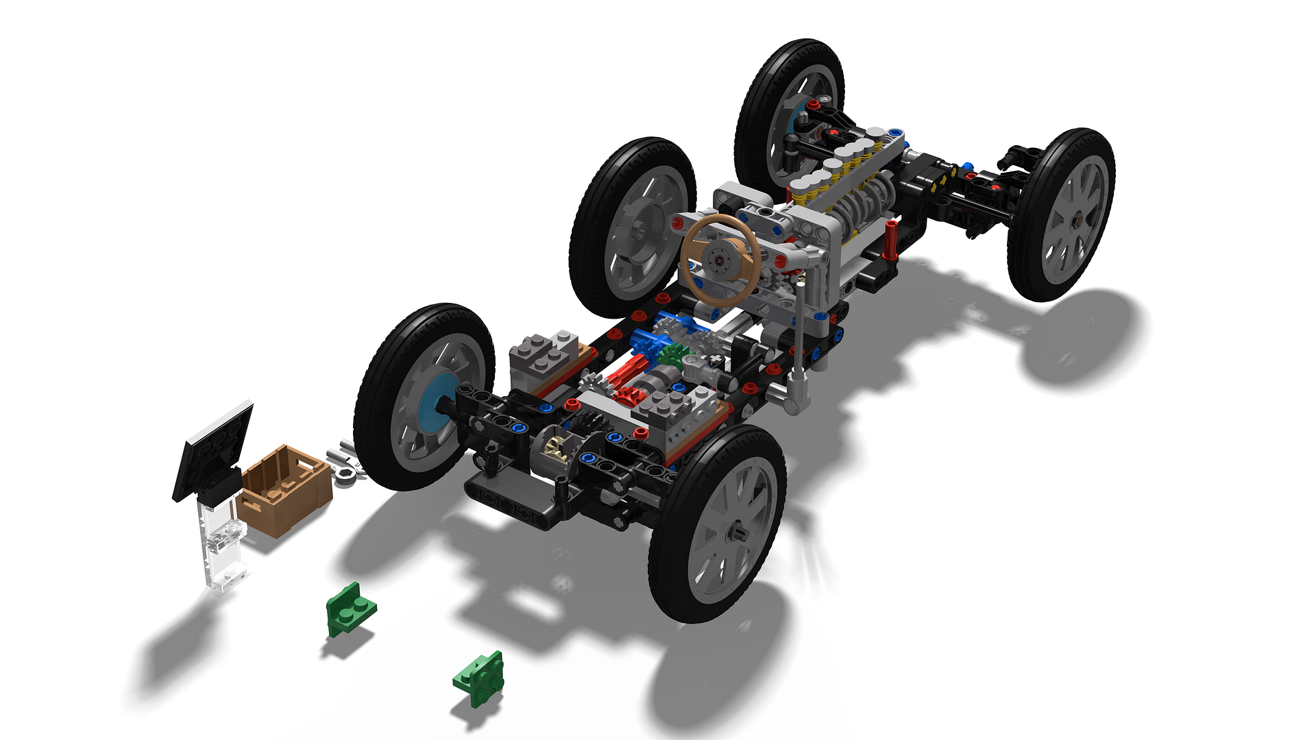

JTS Posted Thursday at 01:43 AM Posted Thursday at 01:43 AM 4 hours ago, R0Sch said: And somebody is actually building it. Fingers crossed for an instruction scan. https://www.instagram.com/p/DaUSVFUljSU/ So I've managed to recreate this much in stud.io based off this image. I thought the DBG half-bushes were a new colourway but apparently came out earlier this year! Can anyone recall the last time a black 20z bevel gear was used as an actual cog and not just as a HOG knob? Quote

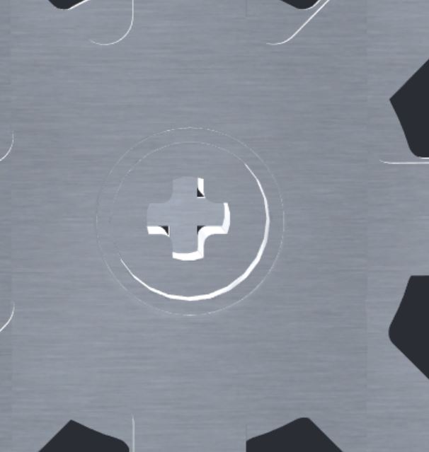

C-Brick Posted Saturday at 01:05 PM Posted Saturday at 01:05 PM I tried making a cad model of the wheel. If anyone sees something obviously wrong please let me know, you can download the part in bricklink studio here and the 3d model (for 3d printing) here. Quote

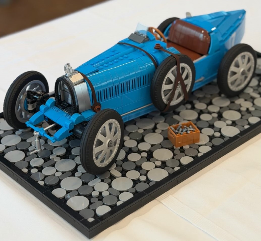

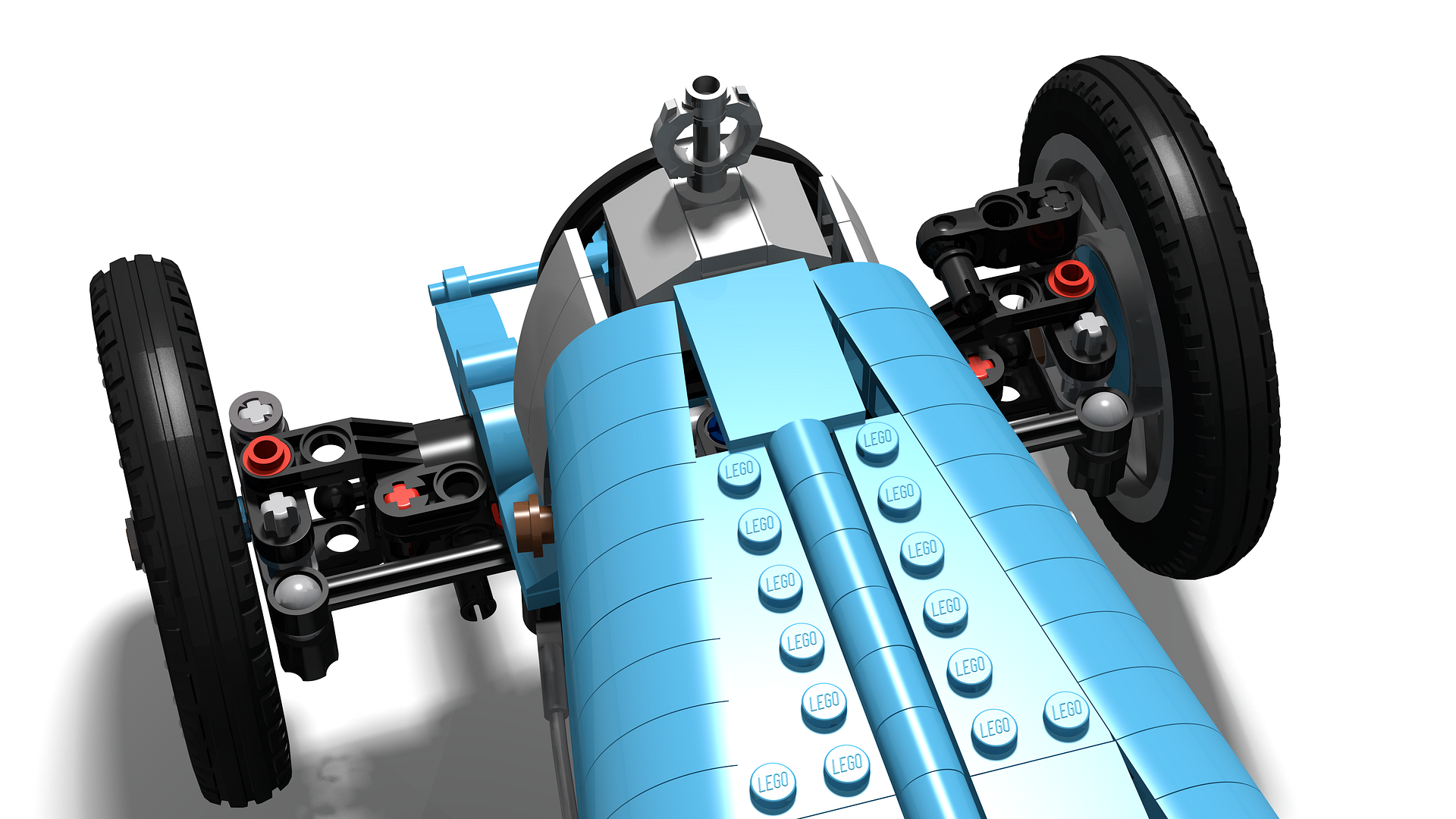

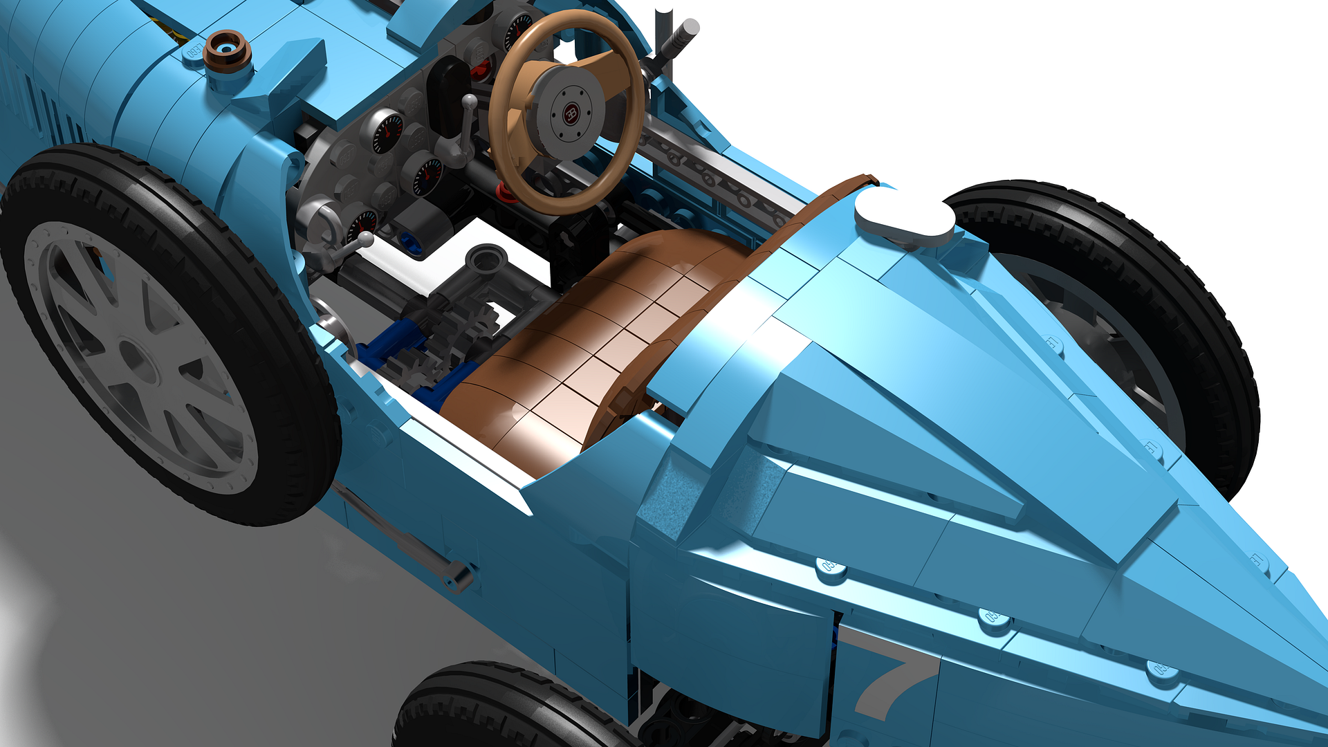

Vaionaut Posted Saturday at 02:22 PM Posted Saturday at 02:22 PM Here's my attempt at recreating the coachwork Quote
R0Sch Posted Saturday at 03:36 PM Posted Saturday at 03:36 PM @C-Brick Nice! Thanks a lot! There is just one tiny issue with the studio model of the rim having the axle hole not completely through, so it appears as having a collision when you connect an axle. Here's another image I found on FB: Quote
C-Brick Posted Saturday at 04:25 PM Posted Saturday at 04:25 PM 42 minutes ago, R0Sch said: rim having the axle hole not completely through, so it appears as having a collision when you connect an axle yeah obviously that was just an error I made in part designer (now fixed) Quote

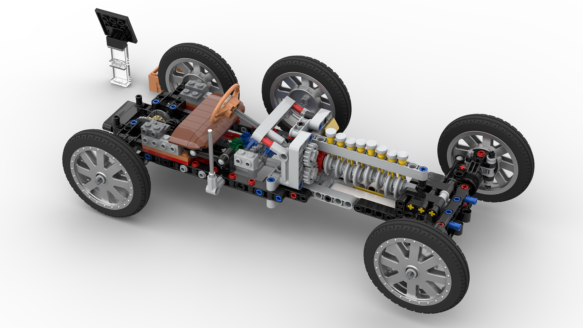

R0Sch Posted Saturday at 07:08 PM Posted Saturday at 07:08 PM How the steering and drivetrain is most likely done: Quote

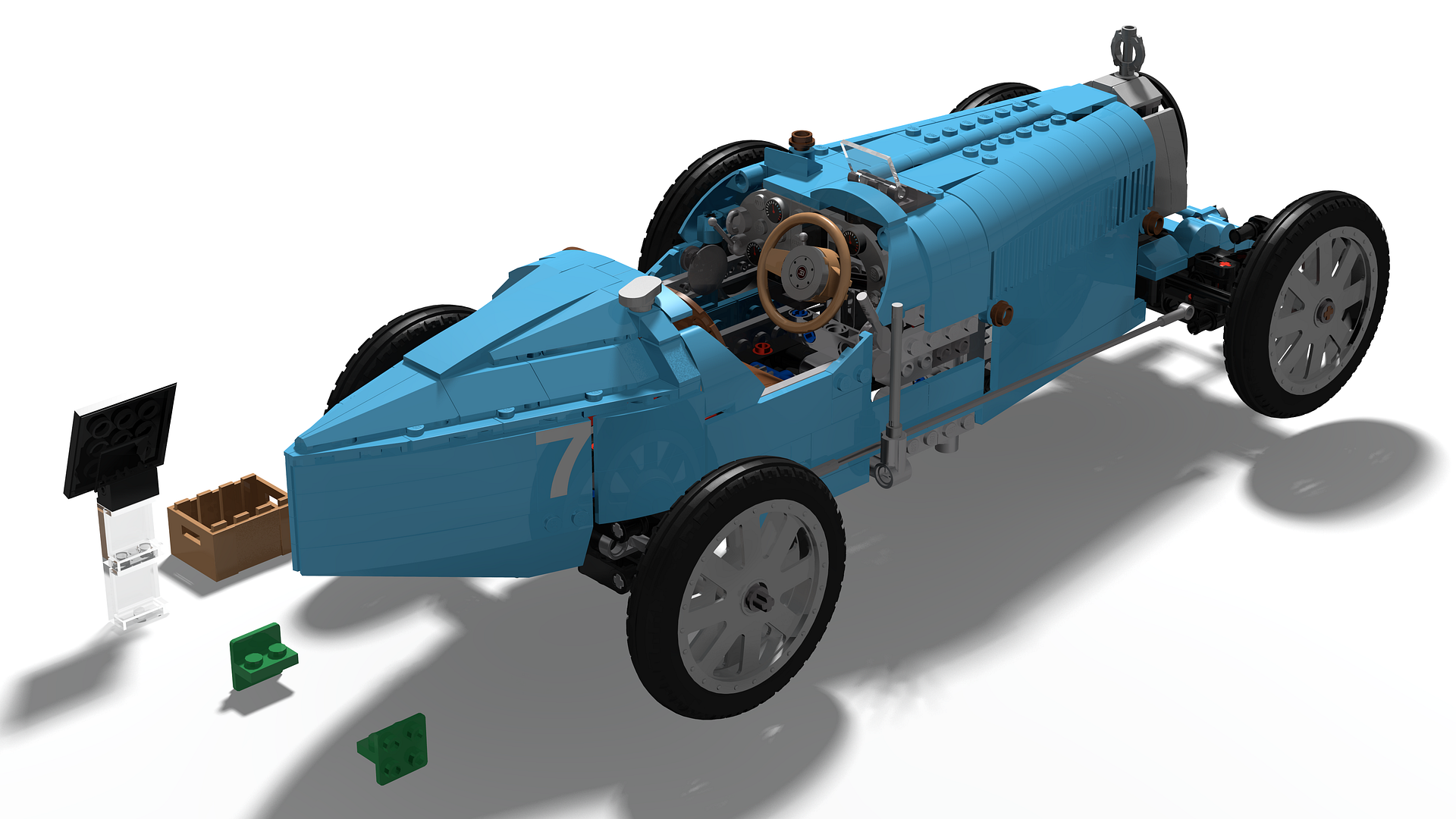

Vaionaut Posted Saturday at 10:48 PM Posted Saturday at 10:48 PM You can find a stud.io file of my current version containing the chassis and the body here, using the wheels by @C-Brick. Now the question is, how to figure out how the rest of the internal build is made in the set? Sure, it wouldn't be a problem to connect it somehow, but it would be cool if it came as close to the original as possible. Also, a really large number of parts have been recolored for this. So this would require either building another color variant or use some spray paint... Quote
BrickWild Posted yesterday at 01:49 AM Posted yesterday at 01:49 AM 3 hours ago, Vaionaut said: You can find a stud.io file of my current version containing the chassis and the body here, using the wheels by @C-Brick. Now the question is, how to figure out how the rest of the internal build is made in the set? Sure, it wouldn't be a problem to connect it somehow, but it would be cool if it came as close to the original as possible. Also, a really large number of parts have been recolored for this. So this would require either building another color variant or use some spray paint... Nicely done! It is possible to recreate this in either Black or White! Still needs a few more corrections though. Quote

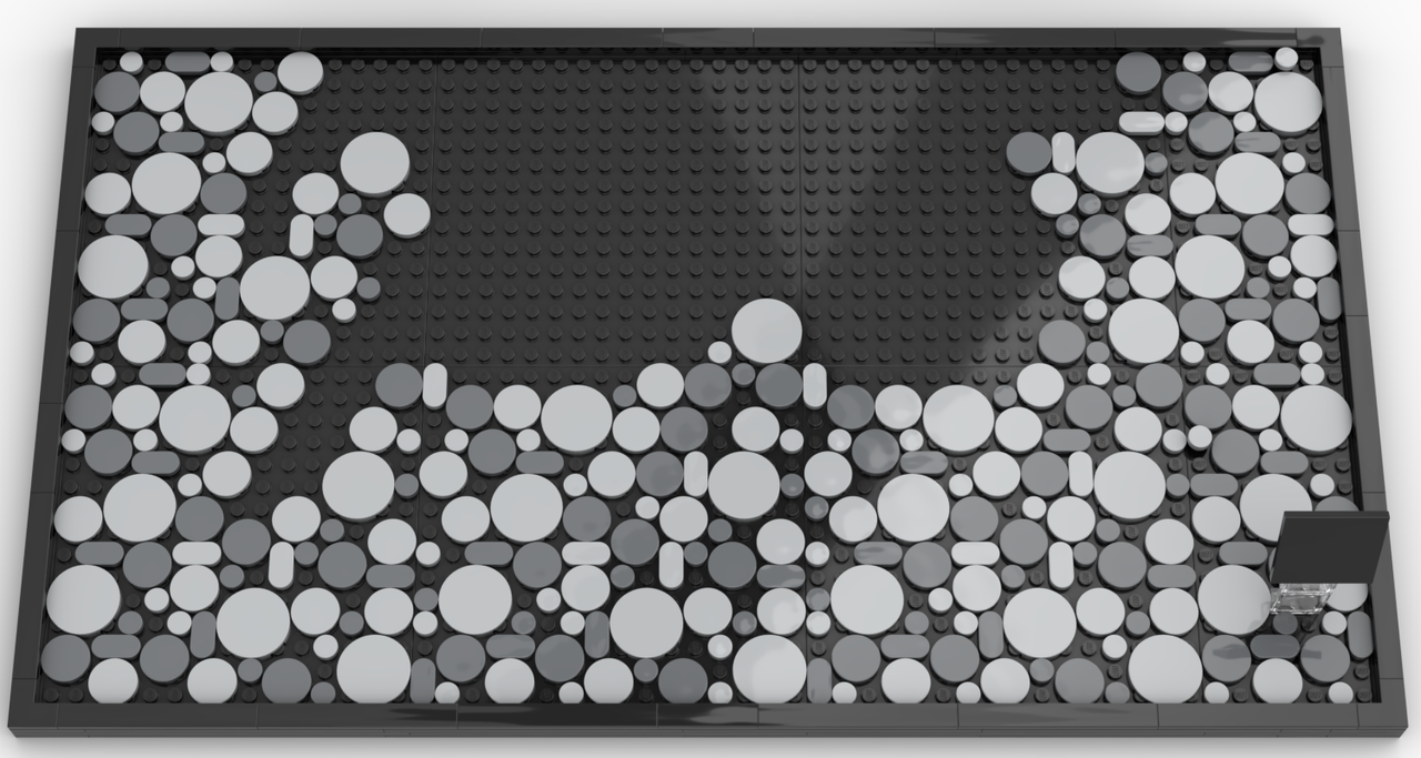

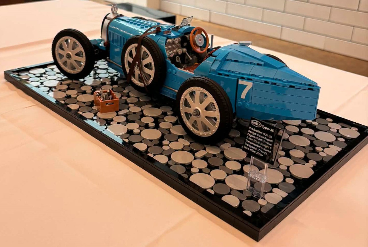

R0Sch Posted 17 hours ago Posted 17 hours ago If you ever felt like you had a really shitty day, you probably never had to build a baseplate like this. Out of the 1592 pcs. over 550 go into this. Quote

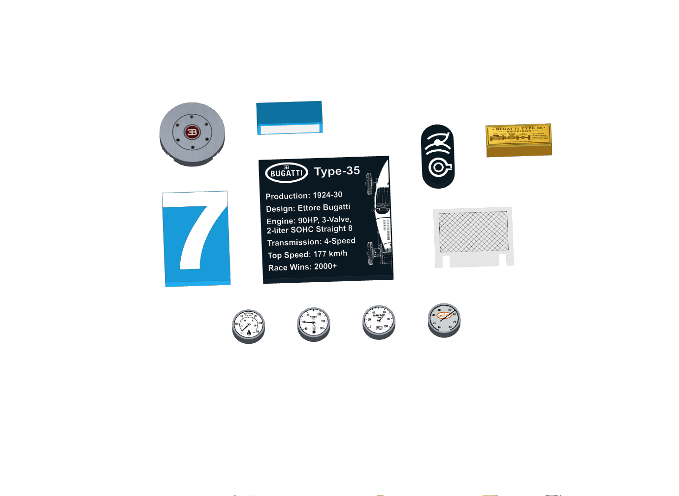

C-Brick Posted 16 hours ago Posted 16 hours ago I am making the decorated pieces (or at least what I am able to make out with the blurry images and ai and gimp post processing) Download them here, I will update it once I get to make more/update them. Quote

CDM Posted 11 hours ago Posted 11 hours ago Everyone is hating on the cobblestones...I think it looks fantastic and adds to the overall model, even if a lot of parts. Plates with printed cobbles wouldn't look nearly as nice, IMO. Quote
Vaionaut Posted 11 hours ago Posted 11 hours ago (edited) 59 minutes ago, Woeff Bricks said: Can you share us a list of the recolered parts? It almost feels like it would be easier to list the parts that haven't been recolored...^^ Many of the dark azure parts used for the body (especially the various curved slopes and wedges, but also, for example, the 3l bars at the front with the Kylo Ren lightsaber connector) Also, lots of metallic silver parts like 3x3 plates with round corner, bars, candles and the inquisitor lightsaber hilt. Then there are the tires that only exist in white, the steering wheel that looks like medium nougat, etc. The list is pretty extensive – just take a look at the stud.io file. Btw, I updated it so that it includes the base and the newly added decorated elements by C-Brick now (thanks for designing these!). Edited 10 hours ago by Vaionaut Quote

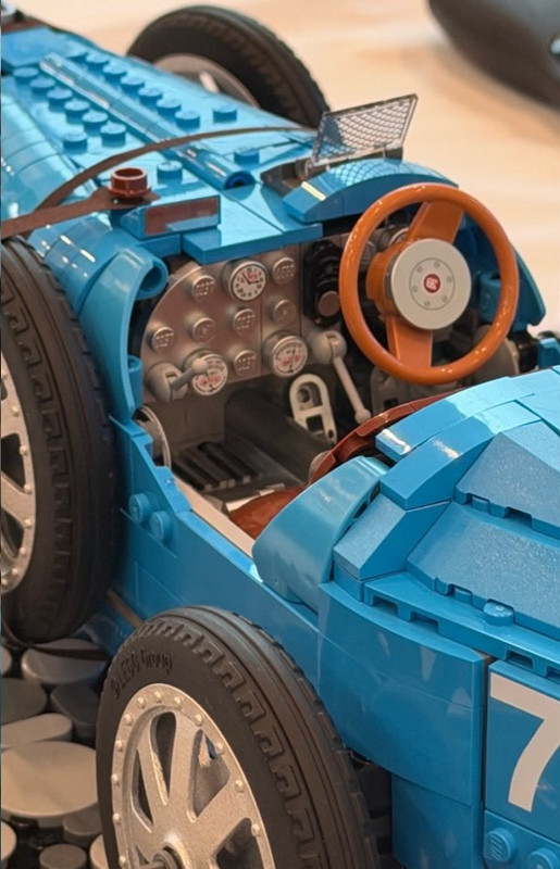

C-Brick Posted 8 hours ago Posted 8 hours ago 15 minutes ago, huguberhart said: Does this image help in any way? This helps a lot, looks like the 2x3 tiles and 2x2 curved slopes are also custom prints. This also makes the wheels a bit more clear. Do you have the set? Quote
huguberhart Posted 8 hours ago Posted 8 hours ago (edited) No, I don't have the set. I tried to look around tiktok. The instagram post is a dead end. There's an update with request for sharing denied.. *By the way, they really went crazy with the prints on this one. Edited 8 hours ago by huguberhart Quote
R0Sch Posted 7 hours ago Posted 7 hours ago Found more pics online. Looks like the box has an outer sleeve as well and they even made an exclusive minifigure print. g Quote
msk6003 Posted 3 hours ago Posted 3 hours ago As far as I know, on the right side visible only from the top of the box, there appears to be some kind of link extending toward the front wheel. According to reverse engineering by others, since the steering shaft passes under the car, it might be a decorative link or have some other purpose. Quote
