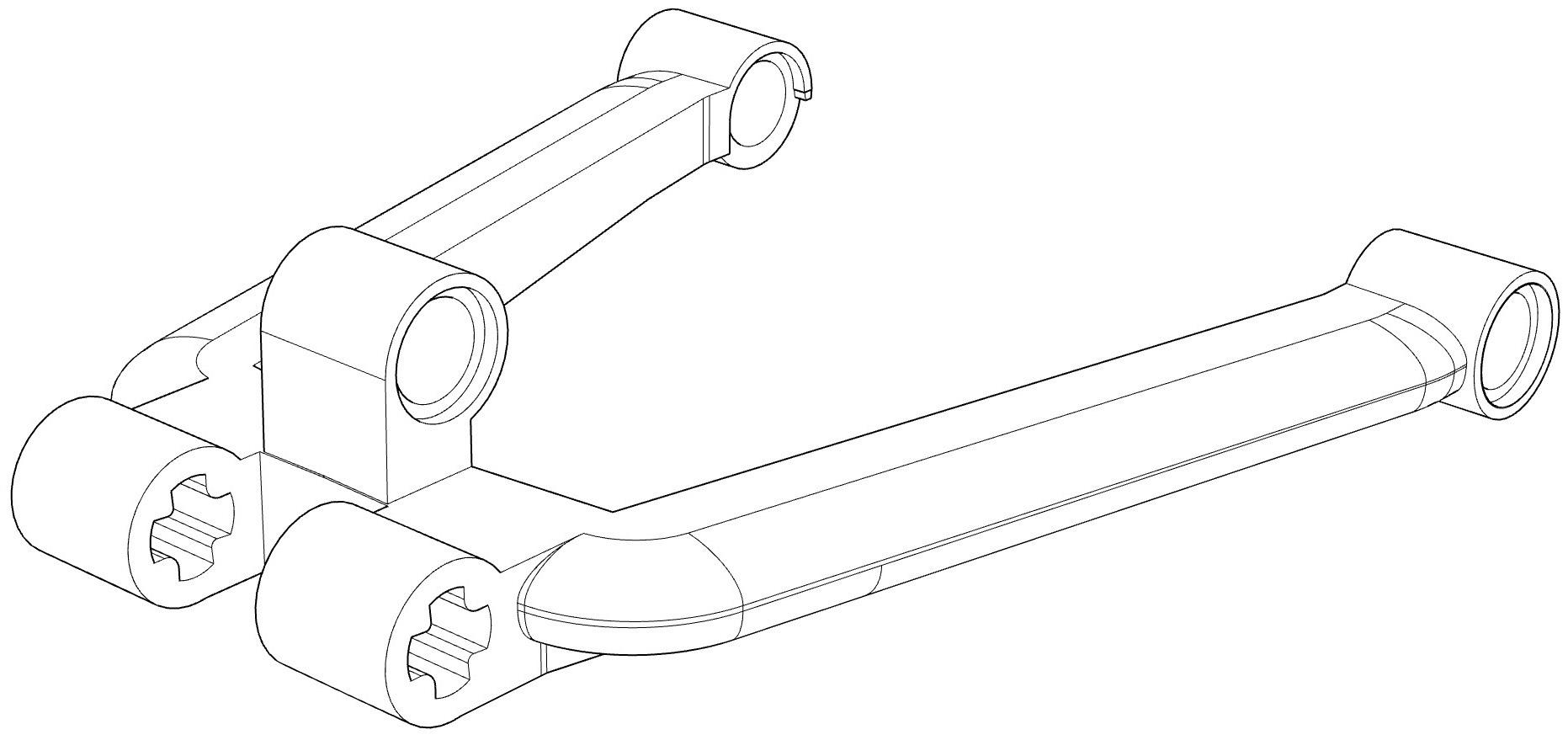

I think its for attaching a towball too, then using a 9L link for pull/pushrod suspension.
I think the 3L suspension arm with towball has an axle hole on it to connect to the really long wishbones and use conventional hubs.
42206_WEB_SEC04_NOBG_en-gb.png?format=we
The spacing is right, I think.

On wishbone pin hole is exactly for that and small (3 studs long) part with towball socket you can see specially on the same image that you posted, but also on Ferrari. Lower part is rounded and it means that towball fits inside...
