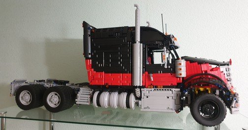

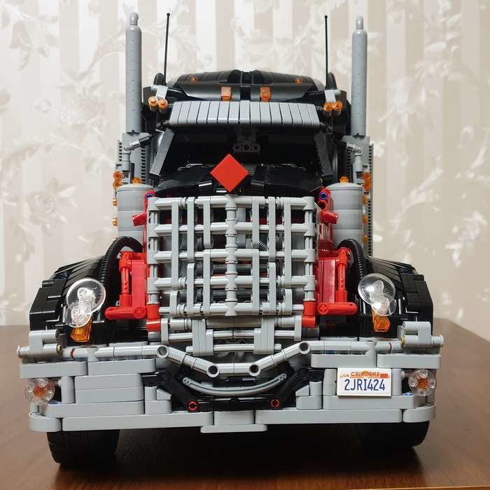

  6. I think the next 1:8 supercar will be a big dark blue Ford. His style is closer to the previous Big Three. Just like a very subtle hint before the big red 2022 Ferrari, the 2021 Ferrari 488 was released.
