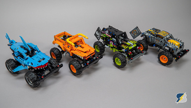

  2. Apologies for not aiming at a 100% accurate color representation, I think if I tried to replicate the medium blue correctly then the orange and other colors would be totally off :) Different shades of LEGO pieces are notoriously difficult to replicate on photos or on video, I use a similar color grading for all of my content produced so there was no specific setup this time either.

  5. Better check the screen settings :) You can verify the part list already on rebrickable, and they are 100% medium blue. I made a video test last year and there was no significant difference in speed, distance or bounciness. I did a quick test now with the Megalodon and the different tires. I have 60x60cm tiles in the room, and with 60 cm windup distance the truck went 560 cm on the stock tires and 490 cm with the tractor ones, that's only ~13% difference. I don't have carpet around here for such comparison.
  6. Thanks! The Monster Jam series is practically unknown around here so I had no preference, Megalodon was simply a more interesting build with more new parts to show.
