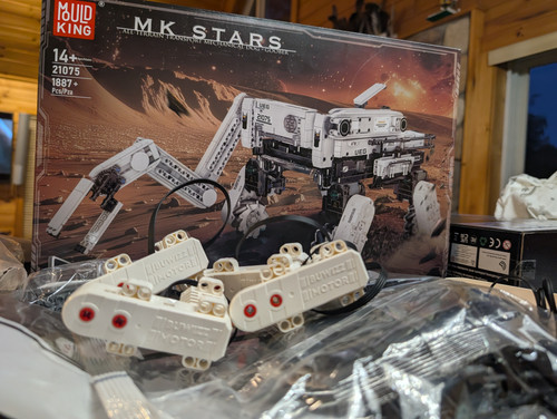

Sorry if I've been out of the loop but I just picked up this MK set because I wanted the white monster motors, turns out they're not MK monster motors?
Anyone know what's going on here?
It's a little hard to tell from the photo, are those LBG or white? Buwizz motors from the past are LBG... those ones look white. Very odd.
Those are white and branded Buwizz
