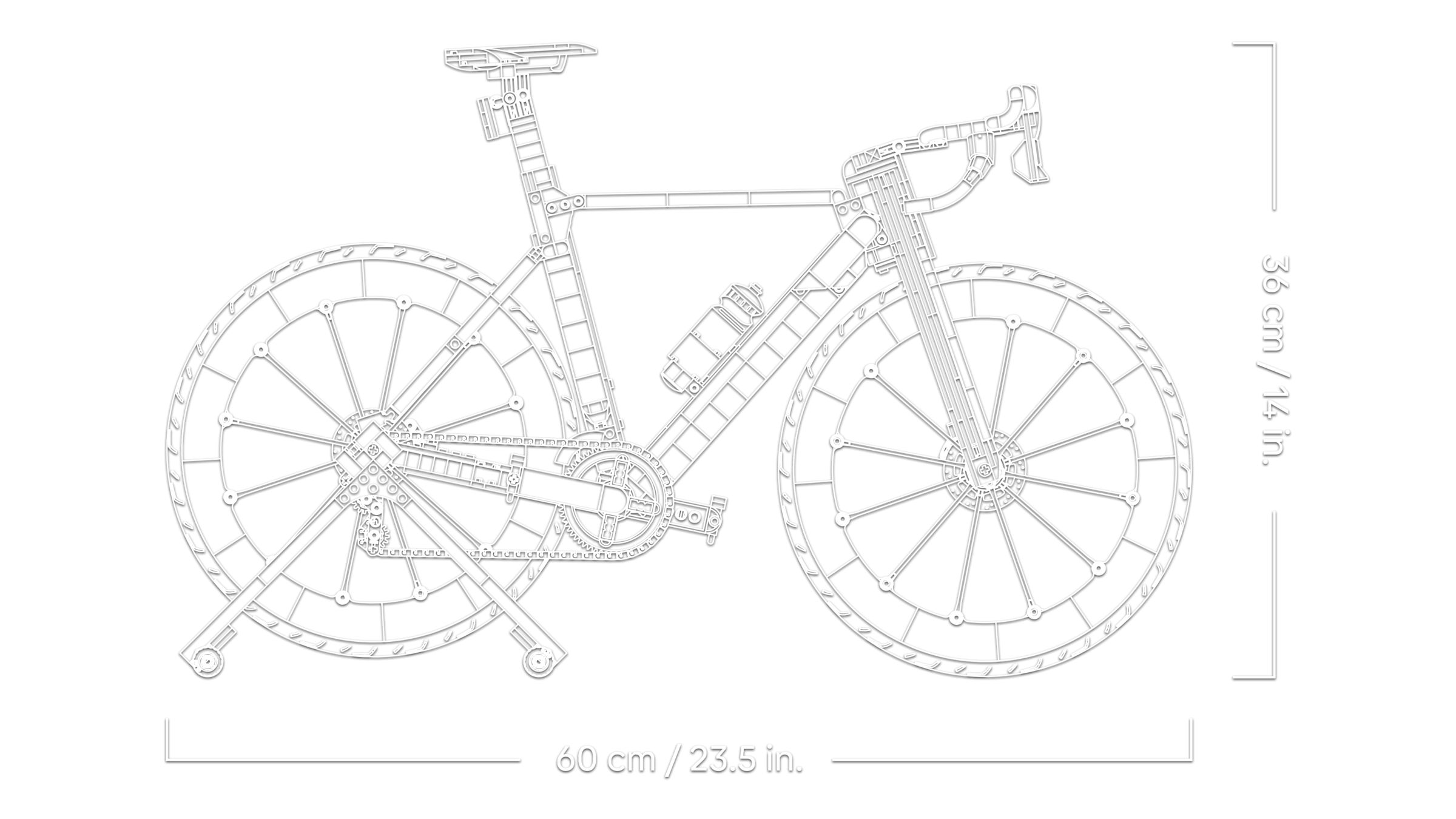

Davidz90 Posted yesterday at 02:33 PM Posted yesterday at 02:33 PM Apparently the bike has a freewheel mechanism, e.g. one way ratchet inside 24t gear. So many new, useful parts! Quote

R0Sch Posted yesterday at 03:52 PM Posted yesterday at 03:52 PM 1 hour ago, Davidz90 said: Apparently the bike has a freewheel mechanism, e.g. one way ratchet inside 24t gear. So many new, useful parts! Correct. I see a new dbg 24T gear. Quote
HydroWorld Outlook Posted yesterday at 03:55 PM Posted yesterday at 03:55 PM (edited) 6 minutes ago, R0Sch said: Correct. I see a new dbg 24T gear. All right! I didn't see that coming! Oh yes—this will be such a useful piece! The introduction of this new part would mean the days of building or 3D-modeling huge, custom freewheeling mechanisms are now mostly over—imagine how much more efficient this part will be compared to mechanisms of the past. Edited yesterday at 03:59 PM by HydroWorld Outlook Quote
gyenesvi Posted yesterday at 04:09 PM Posted yesterday at 04:09 PM 16 minutes ago, R0Sch said: Correct. I see a new dbg 24T gear. To me it looks more like 20T. Quote

Auroralampinen Posted yesterday at 04:24 PM Posted yesterday at 04:24 PM 14 minutes ago, gyenesvi said: To me it looks more like 20T. Yeah, i calculated them and i camed to conclusion that its 20Th gear Quote
R0Sch Posted yesterday at 04:31 PM Posted yesterday at 04:31 PM You're right, because it's smaller than the pulley wheel behind it. Quote

Ngoc Nguyen Posted yesterday at 04:47 PM Posted yesterday at 04:47 PM The ends of the new spoke piece are pin holes, so wouldnt they create slack when they connect the pulley wheels to the rim? Quote
AVCampos Posted yesterday at 04:57 PM Posted yesterday at 04:57 PM You mean, for example, if the rider applies torque to the pedals while the rear wheel is stuck in sand or mud? In a real bike, the tension the spokes are under takes care of that, but in the LEGO version with LEGO tolerances that may be an issue. Quote
R0Sch Posted yesterday at 05:22 PM Posted yesterday at 05:22 PM (edited) 45 minutes ago, Ngoc Nguyen said: The ends of the new spoke piece are pin holes, so wouldnt they create slack when they connect the pulley wheels to the rim? No because they are criss-crossed like real spikes on a bike to the pulley wheels and are under tension. 35 minutes ago, AVCampos said: You mean, for example, if the rider applies torque to the pedals while the rear wheel is stuck in sand or mud? In a real bike, the tension the spokes are under takes care of that, but in the LEGO version with LEGO tolerances that may be an issue. The half pins are with friction so the free-play is eliminated and the links are probably thin enough and not made of elastic material to be put under some tension. Nevertheless I think there is a risk that over time the pulley wheel pin holes will crack at the weakest point due to the tension. That's probably why the rear wheel is supported just by the axle to keep the load on the parts to a minimum. Edited yesterday at 05:35 PM by R0Sch Quote

Thirdwigg Posted yesterday at 07:44 PM Posted yesterday at 07:44 PM I never thought I would be in a place where bicycle spoke lacing patterns and LEGO part tolerances would be discussed. The bicycle wheel only works because the spokes are in tension, and LEGO tends to not do tension. I am curious to see if this wheels is ridged or if the tolerance make it feel a little floppy. Quote

R0Sch Posted yesterday at 08:02 PM Posted yesterday at 08:02 PM 9 minutes ago, Thirdwigg said: I never thought I would be in a place where bicycle spoke lacing patterns and LEGO part tolerances would be discussed. The bicycle wheel only works because the spokes are in tension, and LEGO tends to not do tension. I am curious to see if this wheels is ridged or if the tolerance make it feel a little floppy. Looks like there is one half pin on each wheel that is a frictionless white pin. So there might be some tension on the spokes after all. Unless it's just an orientation color coding. The arch segments have double axle pin connections so they will be fairly rigid by being held together by the rubber tire. Quote
