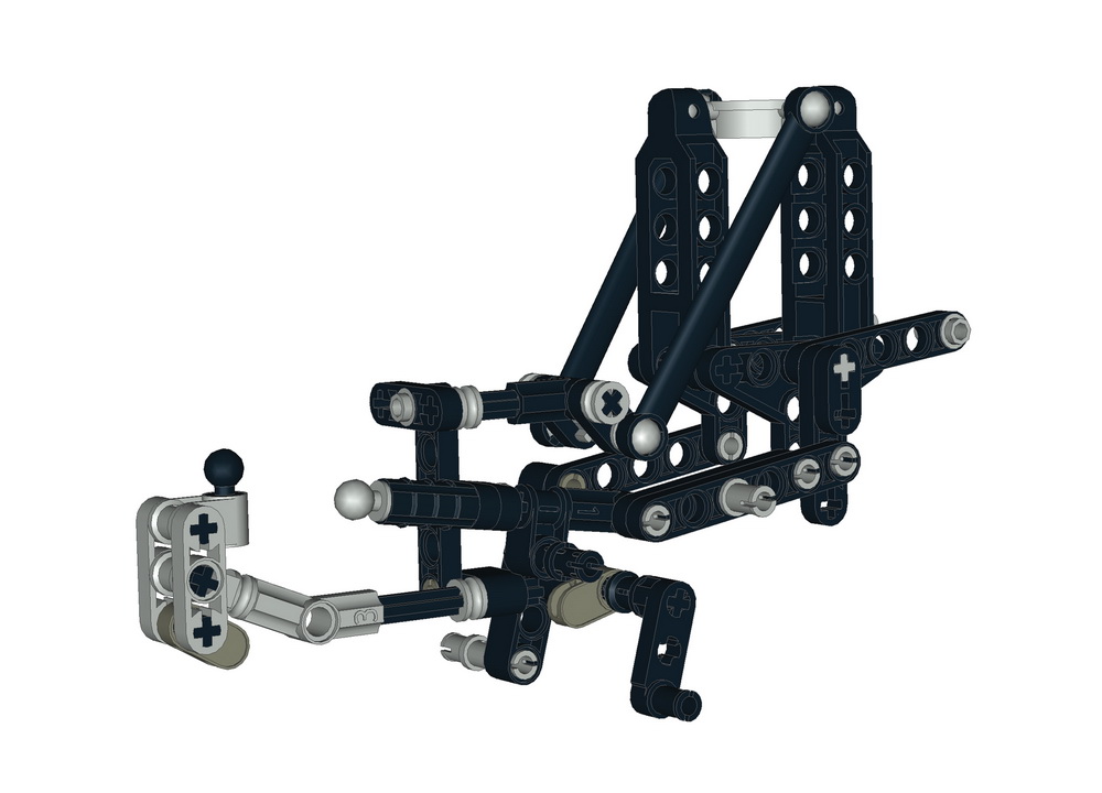

I saw some of the images of the new helicopter that LEGO are bringing out this summer and it inspired me to get my old MOC out of the box and figure out a way of adding collective pitch to the system. In the end quite a compact mechanism
More images on Mocpages

Cheers :classic: and yes I am waiting for some of those rotor blades from 9396. Hopefully they would have out both collective and cyclic controls into a model that size. If not, shouldn't be to difficult to mod with something similar to my mech.

Nice video. Do you have any CAD of the mechanism? If so, I might do some experimentation with it?
Cheers Paul
