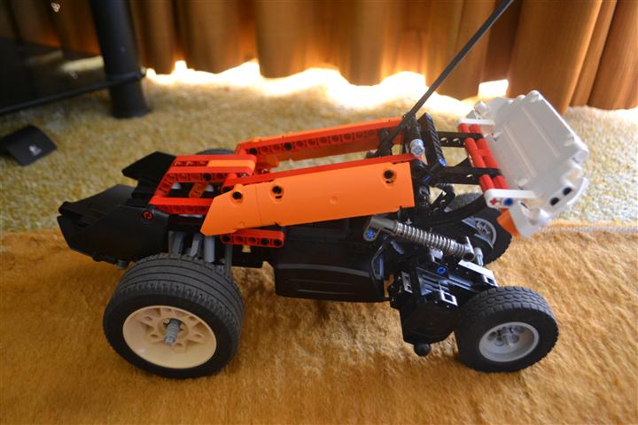

Update on my plans, just want to run it past you guys. My updated plan is to run two buggy units of one battery. Here's the battery I have chosen http://www.trademe.co.nz/toys-models/radio-control/parts-accessories/batteries/auction-569657843.htm My knowledge is that a buggy motor draws about 3.5amps of current so four of them will drain 14amps. I calculate this battery of being able to exert 20amps, it is also very light at 110g. I will keep the battery external and wire it upto the units, the covers can stay off the units so no modding of the units will be needed, which I feel better about knowing that they are rare. Well there's my tentative plan as it stands. Here's my little car as it is. -

Hey guys, I have been slowly building my hill climb RC car and I have pretty much built a simple car, just to see how all the parts perform. I am using the RC buggy unit and two buggy motors powered by 7.2v of rechargable batteries. So far I am direct driving two smallish wheels off the slow outputs of the motors, even though I am using the slow outputs the car lacks torque uphill, speed on the flat is about right though. I want to gear it down for uphill but then I will lose speed. So I was thinking of adding 3 more batteries taking the volts to 10.8v to get a bit more rpm. I was going to drill holes into the RC unit and thread wires through it, series wiring the 3 external batteries to the 6 internal. Is this wise? Is there a better way?
