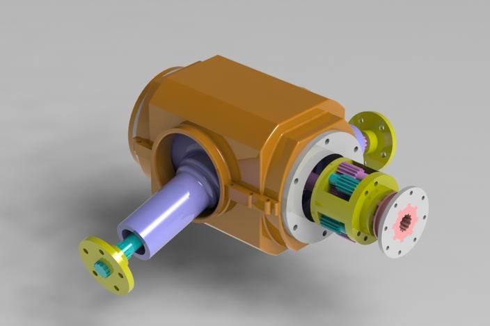

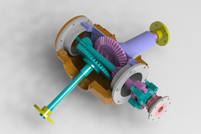

  4. Yes the differential is housed as a planetary unit buildt into the axle (I would want to have it in front of the axle).. With the small gears being the planet gears and the two middle gears in this case the sun gear... The input drives the whole outer ring or the housing which turns the shafts for the pinion gears. In this case two of them, again... How ever when one wheel slips the planet gears will transfer all power to that wheel. Just like a real differential will. Here are some more pictures: PS: In my opinion it should be an addition to the tatra axle you already mad,e it looks great. So for that to be possible we need an alternate of the end "caps" which will allow for both the tube-axle and the regular axle to go through.

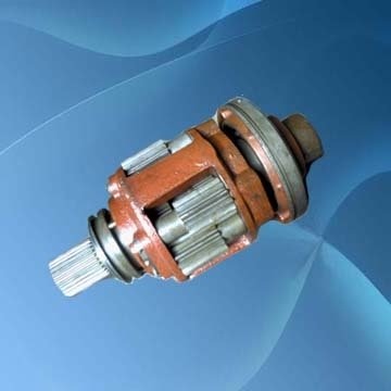

  5. How about making it possible to make a real tatra linear differential like the one in the attached photo. I have made a large scale one, but i believe you can make one with 10t gears... For small scale... It requires though some custom parts... For example a tube axle with a 10 tooth gear on one end and a 20t or 12t bevel gear in the other end... And something like the 6 hole pulley wheel the tube axle can go trough...Could you make something like that??
