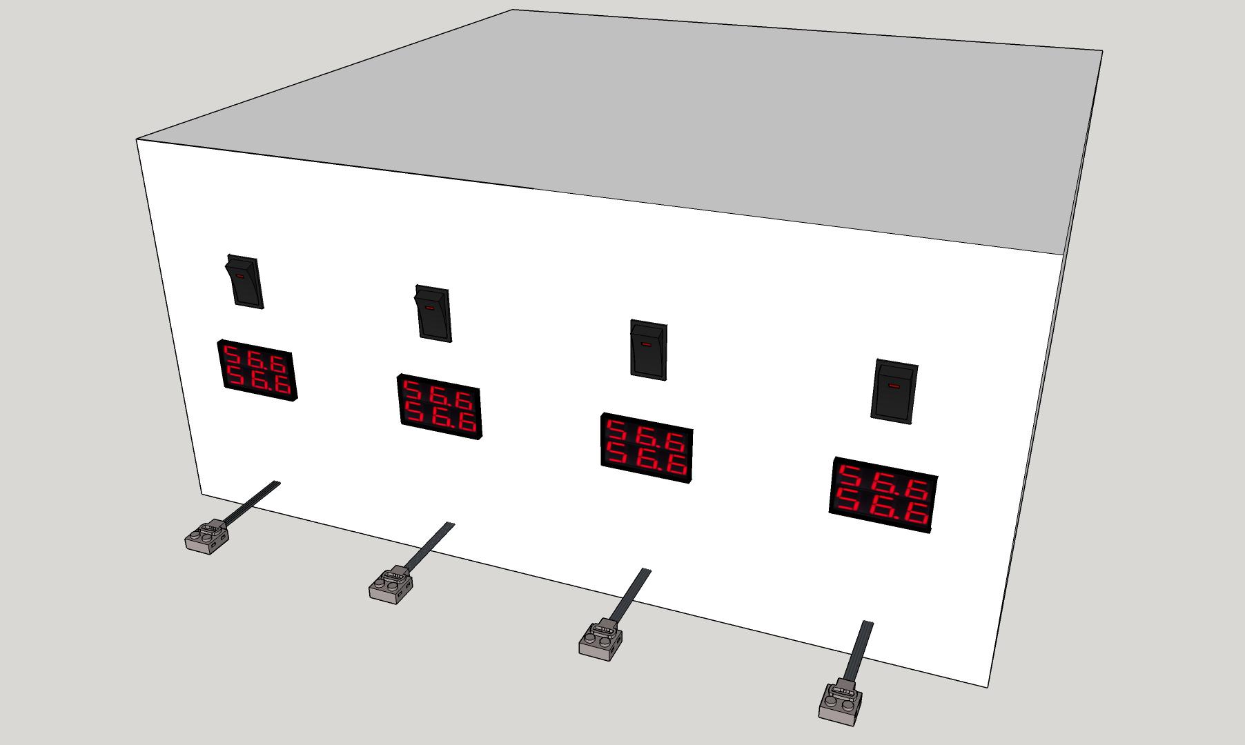

Thank you Captainowie, that is exactly what I mean! VERY helpfu info! It inspired the following idea: I'll buy a power supply(possibly a computer one) 4 on/off switches 4 voltage regulators 4 amp limiters 4 AC voltage& amp meters 4 PF connectors (from 2 cut up extension leads) I'll split the supplied power into 4 leads each with it's voltage reduced to 9V and it's current limited to 3A then put in a AC volt& meter and then connect the PF connectors. the Idea is that I can just click on a Sbricks & motors and when the amp peaks go near the 3A under full motor stress I'll know to start using the next output channel Is this a plan that could work or am I bound to run into problems here?
Thank you for your reply's everyone! I think a 9V AC adapter wit a 3A output connected to a modified extension is the way to go for me. I don't se any reason to use bulky train controllers since the speed regulation will be up to the Sbrick. My electrical skills are minimal, but as I understand it I can only hook up a limited amount of motors to a 9v 3A AC power supply. what is a good rule of thumb here ? 4 XL-motors,6 L-motors ,8 if there M-motors?
