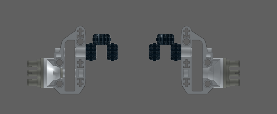

RC Rock crawler. Features AWD drive without differentials using 69730 "Large angular position motor"(As it has realy good torque), Steered by L-motor, and springless suspension (concept by superkoala). Lack of differentials gives nice off-road perfomance, but the crawler has big steering radius due to that.

5 minutes ago, msk6003 said:
Damn I also made offroad vehicle using 42114..
How to make 4wd when this set has only 1 U-joint?
The suspensions are simply two linked pendular axles, so no U-joints are needed. The steering uses gears instead of u-joints, like this:mechanism.png.fb08523c9aa5b2e8a4b90c55d112dc85.png
Except I use 2 thin 12t and 1 thin 20t for each front wheel and don't use portal axle, setup is same with mine... I neeed to think other.
