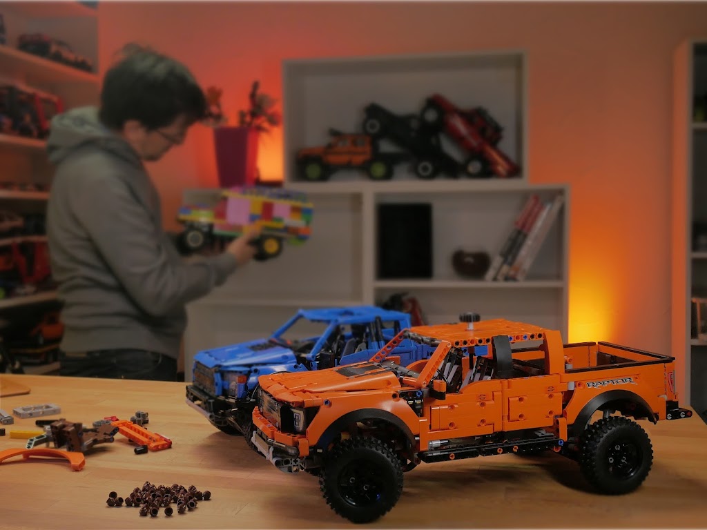

6 hours ago, Mechbuilds said:
I'd like to message the designer who made the blue raptor. Can't find who designed it from google..
Instructions for the blue one would be awesome. I wonder if he'd share them.
If there's one thing I like so much more about the blue, it's the design of the front. Particularly the small panels on top of the headlights for the orange version are just not well placed in my opinion.

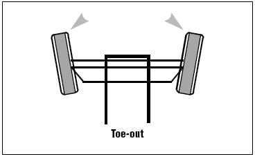

Just built this set a day ago and I noticed it has a ton of rolling resitance. It seems to happen with original tyres only, any other ones are much smoother. Anyone else noticed that?
yes, I noticed that in my review
the problem of resistance is the front axle
1) rounded wheels have tendency to turn easy instead of driving forward, especially on bimps - not much rolling friction
2) steering rods behind the axle
3) too many backlash, front suspension arms are too wobly
4) wheel hubs with 2,5 offest.
So all that thing  front  axle increase toe out
but rear axle is also have resistance more than usual

Thanks for the confirmation. It seems these new tyres have a really good traction and they are very sensitive to both high weight and incorrect geometris.
