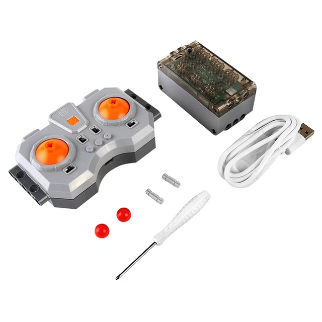

I've just found out there's a version with a 6-output receiver and a transmitter with 4 proportional channels (and 2 bang-bang). Anyone tried this?
Mould-King-Power-Functions-Parts-MOC-hig
May I post a link to the Chinese store where I found this, @Jim?
This combo is used in the mould king 17006 and seems to work good.
