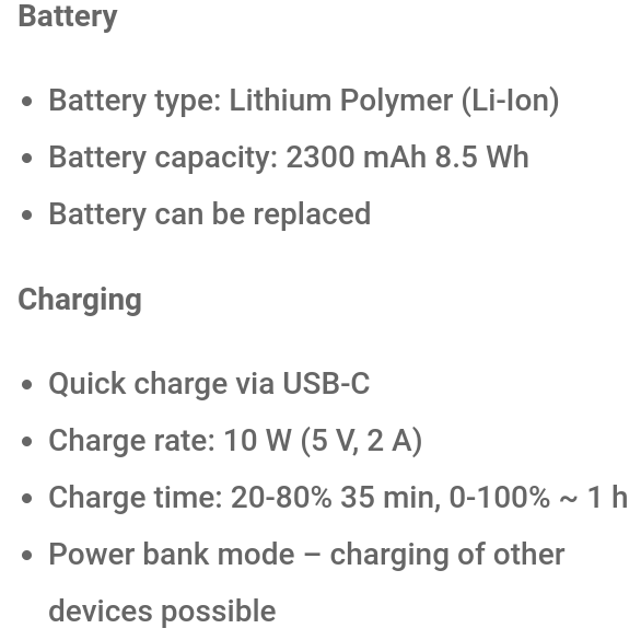

I was interested in the following aspect regarding the Buwizz 3.0 battery - the manufacturer's website states that the battery capacity is 2300mA / h and that the battery is replaceable. on the Sariel video, when parsing, it is clearly visible that the HPL 502852-5C-381P element is used at 11.1V 800mA / h 8.88Wh-where is the truth? and second, if the battery is replaceable, what batteries and with what characteristics can be used in this device? It would also be interesting to know whether the battery charge controller is built into the bank or is it soldered on the motherboard? Thank you in advance for your feedback!
Edited by Danil
Both are correct. It's a ~8.8Wh battery. (Wh)*1000/(V) =(mAh).
At 11.1V (which I assume is the maximum discharge voltage), it's 792 mAh.
At 3.7V, it's 2378 mAh. This provides an easy comparison point against phones, laptops and other small electronic devices which also use 3.7V for showing their capacity.
Still does not make sense. The battery in the picture reads 880mAh and on the buwizz page it is 2300mAh.
You also need to be more careful with units. mAh*V=mWh
Why buwizz does the calculation with 3.7V (the value of one lipo cell) is strange to me. General the actual voltage of the battery is used like in the picture: 800mAh*11.1V=8.88Wh=8880mWh
And I assume buwizz uses a 3s lipo battery at 11.1V

That's interesting. And proves I was wrong as they use a 1s battery :)
the blue battery is 3s1p which means three 3.7v cells which sum up to 11.1v (series connection) the silver battery has two 1s cell in parallel connection (1s2p) which ads up the capacity of the cell but the voltage stays 3.7V. Thus they need a step up converter for higher voltages.
Bit if the blue battery is from a buwizz 3 this is a 3s lipo and on the homepage the data implies a 1s lipo. I am confused.
Would like to have someone else to look at this as I only rushed through the data :/
2300 > 880. Sounds better :pir-wink:

@Toastie ur right. But they way it is written on the buwizz homepage it looks like a 1s configuration as they use 3.7V for their calculation. 2300mAh *3.7V = 8.5Wh not a 3s config as seen on the blue battery...

@Danil there is nothing wrong with the buwizz 3. The numbers are correct and there is nothing wrong with how it is described. I would rate the data for the battery as expert knowledge. Most people don't wanna know how it works but here u can look it up if you know how to read it.
The data for the buwizz 2 on the homepage (indicates a 2000mAh battery) does not 100% match the actual battery (1900mAh) but for the user it hardly makes any difference and maybe they changed the supplier and the page wasn't updated. But also nothing to worry.
@BrickTronic u can't just add up the capacity for the buwizz 3 only because there are three cells. At 11.1V it can deliver 880mA in one hour this 880mAh. To triple the capacity you would have to go from 3s1p to 1p3s. Then it could deliver 3*880mA in one hour at 3.7V.
Charging of lipo and li Ion batteries is, if there is more than one cell, done with a balancer which is connected to each cell and checks the load (current) of each cell while charging. If one cell receives to much load it is broken. Also there is a special 'charging curve' which needs to be followed. The is done by a charger and the whole electrics for this is inside the buwizz.
