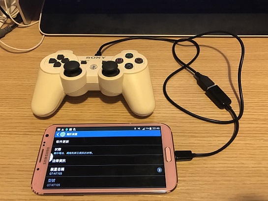

Desmond Posted February 23, 2017 Posted February 23, 2017 I have tried version 0.9 on an Samsung Galaxy Note II LTE GT-N7105 running Andriod 4.4.2. I connect the PS3 controller to the GT-N7105 with an OTG cable as shown in the attached picture and it works. But not for Bluetooth connection. I use it on a car with 4 M Motor for acceleration and 1 Servo Motor for steering. I assign Button A to go forward, Button B to go backward, Left Joy Horizontal to do the steering. Below are some observations: 1. When the car is moving forward and I want to go backward, I have to release A and wait until the car stop (about 1 sec.) and then press B. If I press B without waiting the car stop, I will experience a power drop and the car can only go backward with lower speed (sometime even don't move), just like it is running out of battery. If I release B at this situation and wait for about a sec., full power backward or forward can be resumed. 2. Sometimes when I launch the app, I can test the channels of all SBricks under the "Manage SBricks" but when I play a profile, the connection just can't be established. If I go to the bluetooth menu, I can see that the SBricks are not connected and I need to turn off bluetooth and on again and connect each of the SBricks under the bluetooth menu (not in the app). Am I doing something wrong? Quote
PKW Posted February 23, 2017 Posted February 23, 2017 (edited) 4 hours ago, Desmond said: 1. When the car is moving forward and I want to go backward, I have to release A and wait until the car stop (about 1 sec.) and then press B. If I press B without waiting the car stop, I will experience a power drop and the car can only go backward with lower speed (sometime even don't move), just like it is running out of battery. If I release B at this situation and wait for about a sec., full power backward or forward can be resumed. are you sure it is not the BB that is damaged? try to accelerate by repeatedly pressing A button and see if the car slow down after some acceleration, it can be the thermal cut off of the BB that is old and cut the current at a lower power consumption than it should be (well.. 4 m motors are a lot) even try to go forward/backward with only the BB switch and see if the problem appears again, if yes change BB (but not batteries) and try again with the sbrick. Edited February 23, 2017 by PKW Quote

AVCampos Posted February 24, 2017 Posted February 24, 2017 Have you tried the official app to see if the problem lies within the controller app or the SBrick itself? On 23/02/2017 at 1:14 PM, Desmond said: I connect the PS3 controller to the GT-N7105 with an OTG cable as shown in the attached picture and it works. But not for Bluetooth connection. I bought a non-official PS3 gamepad for that same purpose, and also wasn't able to connect via Bluetooth, either to the phone, the tablet or the computer; only via USB. It did work via BT on a friend's PS3, so I let him keep it and bought myself a generic gamepad, which does work. So, we can conclude here that PS3 controllers can connect wirelessly only to PS3 consoles. Quote

PKW Posted March 3, 2017 Posted March 3, 2017 On 25/2/2017 at 0:52 AM, AVCampos said: Have you tried the official app to see if the problem lies within the controller app or the SBrick itself? I bought a non-official PS3 gamepad for that same purpose, and also wasn't able to connect via Bluetooth, either to the phone, the tablet or the computer; only via USB. It did work via BT on a friend's PS3, so I let him keep it and bought myself a generic gamepad, which does work. So, we can conclude here that PS3 controllers can connect wirelessly only to PS3 consoles. It does but you need the to be the phone root user and use some kernel (or even a paid app) to find controller id, so it actually doesn't on most samsung phones, I think some Sony should have BT keys for linking to ps3 controller as mac computer but i'm not sure Quote
AVCampos Posted March 3, 2017 Posted March 3, 2017 Yes, I have a Sony phone and indeed it has a settings item to connect a PS3 controller. However it didn't work with my non-official one. Quote
