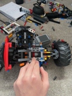

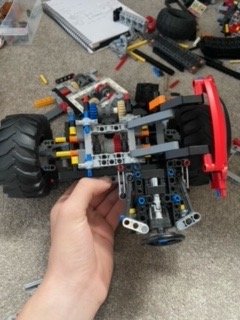

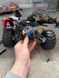

I’ve been working on this model for ages now, and it is finally starting to come together, but keep taking apart and rebuilding things as I’m a bit of a perfectionist- probably why this is taking so long the goal is to have a motorised model with as many features as possible, I’m focusing on the realistic aspect instead of making it fast. Also due to having limited motors it will have 3 xl control plus motors to drive, and 2 m motors c+ for steering and gears 10 speed gearbox (like the real one, although focusing on the paddle shifters rather than the complicated computer in the real one - https://www.google.com/amp/s/www.motor1.com/news/260390/ford-ranger-raptor-no-manual/amp - (they only make them in automatic) more ‘modified’ as appose to ‘stock’ - better travel, front and back diff locks, etc red and black (mainly because I have the most red parts) would appreciate any tips or suggestions :) the main problem I am having is making a 10 speed gearbox (will probably settle for an 8 speed) also I’m not sure how to make the steering stay straight with such large suspension travel - the wheels keep turning inwards when the springs are compressed. sorry for such a long post, will try to put some pictures but the file size is to big :( currently making the front diff lock more compact
