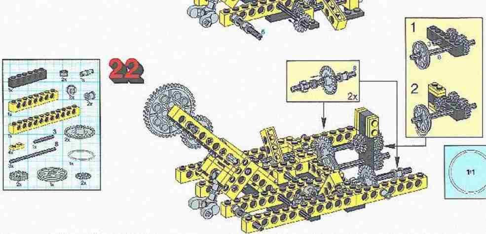

Hi, the real challenges were in the 90s :). In the last few years i have bought and built 8880, 8868 and 8865, among others. The instructions are as follows: take these 20 parts and try to recognize the differences to the last building step on the picture. And there is no color coding. For 8880 there are black, black and black parts :P In the new sets I hardly make any building mistakes although I build quickly and without focusing. In the old sets I made some mistakes even though I built slowly without distraction :) As a bonus, there is the penalty of the old pins with high clamping force if you have to build two or three building steps back B) So get an old set as a challenge. Buying used sets is even cheaper than new ones (that might be my personal gut feeling). Last but not least, you often have to dismantle entire sets, clean the parts and, if necessary, buy defective, incorrect or missing parts :) I spent more time with 8865 than with any new set. Looking for a used, acceptable set, buying paper instructions, dismantling, cleaning, checking parts, buying new ones or replacing existing ones and building took quite some time. But I enjoyed every part of it for the bargain of 60$ in total!
