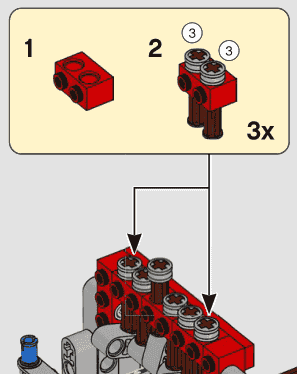

  12. I can confirm that the pnematic cylinder is moving a bit when the bar is retracted. The proposed solution works much better but the tube gets squezed by the tow bar in its upper position - respectively prevents from being fully upright. To me it already made a difference when I removed the blue 3L liftarm and kept the tube inside the grey connector. I made another observation: When I push the truck in forward direction the 'cylinders' in the fake engine often block the rotation of the crankshaft. This does not happen if the truck is moved backwards. I have bulid the motor accroding to instructions: (Step 334) End of brown axle is levelled with the 1/2 bushing. This appears to be a similar issue as with the first version of the 42112 cement mixer. Raising the brown axles by (almost) 1/2 L will remove the issue.
