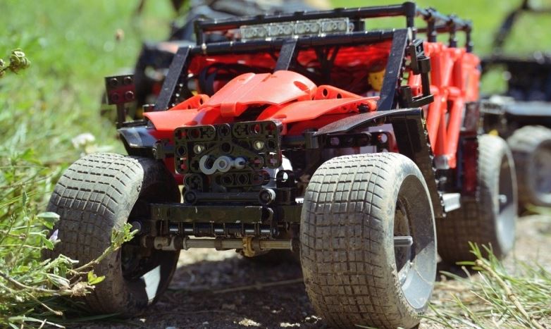

Hello. Today I want to introduce my competition truck for this year's Czech LEGO truck trial competition. Original Vehicle: My MOC is based on Ural 4x4 that was raced by a Polish team of Ostaszevski 4x4 Team for a few years. The truck participated regularly in European cross-country rallies and truck trial competitions (according to photos). I did not find any technical data of the vehicle, just photos. But you can see different evolutions of the vehicle: changing frond end from Ural 375 to newer Ural 4320, changing color of a roll cage, changing wheels and, of course, adding scars to the vehicle. An interesting feature is the roll cage, which is attached at the front by a pivot pin. This makes it possible to twist the chassis frame of the vehicle without breaking the roll cage (this can be seen on czech Praga V3S trial specs). Even more interesting is that the racing team moved the front axle ahead in compare with serial Ural truck. This improved the weight balance between front and rear axles and at the same time increased the approach angle. I chose this this vehicle as a base for two reasons: 1) I built Ural 4320 6x6 when I started participating in Czech LEGO truck trial competition four years ago. And this year I wanted to prove myself that I improved my building skill and I wanted to create a nicer model. 2) The Ural Team Ostaszevski is the most interesting competition 4x4 truck I've ever seen. Especially on desert photos it looks like Mad Max kind of truck. MOC: Scale of the model is 1:12.5 (1 stud = 10 cm). Dimensions: width 26 studs, length 57 studs, wheelbase 38 studs. Weight: 1600 g. I think all basic proportions are accurate to one stud (sometimes half). Only the front bumper is wider than it should be (required by our competition technical rules) and wheel rims have a larger diameter. But tire circumference is all right. Even the longitudinal beams of the chassis frame correspond to the original. There are two PF Large motors that drive all four wheels through the 16:16, 20:12, 20:12, 24:8 gearing. There are no differentials in the drivetrain, but the rear axle drive is able to disengage. This is controlled by a pneumatic piston, but due to the wrong design of the disconnection it does not work anymore (actually worked when it was new). The PF Medium motor is used to steer the front axle. Due to steering geometry, Ackermann's steering is achieved (the inner wheel turns more). And steering wheel is connected so it rotates while steering. Other equipment required by competition rules: manual winch, front and rear tow hooks, seat belts and attaching points for number plates. Drive ability: I tried to get the most accurate imitation of the original truck with cost of worse off-roading ability at competitions. For example: approach and departure angle could be better, the cab is heavy and those tires do not have a best offroad thread. But it is better than I expected. The axles are not sprung (the axle does not have any travel), but I use the torsionally soft chassis frame. Just like the mentioned Praga V3S truck. That was probably the most difficult for me. Design two longitudinal beams, just soft in torsion, stiff to bend and not break apart while twisting. This was done and chassis flex is quite nice. Also the wheel travel looks natural (not as a turntable on one of the axles, the rest stays stiff). I also like that the entire drivetrain is hidden in the chassis frame. Only the steering motor protrudes under the bonnet. It is compact and the chassis itself reminds a chassis of real truck. The chassis, the cab and the flat bed are independent modules as in a real truck design. The thing Porsche 42056 was promising, but did not match that. To be honest, it has some technical issues: 1) Gearwheels mounted to L motors (16tooth) wind up long grass in between them. 2) As already mentioned, disconnecting of real axle drive has stopped working. 3) In the last section of the second race, the front axle U-joint has cracked. 4) I do not believe the 24 tooth gearwheels in front wheel hubs. But they have not broken on the Ural yet. Anyway, the biggest weakness during competitions is the driver for sure :D Car control: I believed you noticed there is not a single battery box on the truck. That is correct. In our trial competition rules is drive-by-wire allowed. We know it looks lame, but there are main reasons for that: 1) Weight reduction - Batteries are part of your controller and car doesn’t have to carry them. 2) Control precision - LEGO offers only IR remote control (so far) and that is useless outside on direct sunlight. 3rd party receivers were forbidden until last season (100% pure LEGO), but sBrick is allowed since this year. Still, no one use it because it not as precise as old 9V BBox and because of weight. 3) Pneumatic control - we can use pneumatic hoses for diff locking, gear shifting or suspension adjusting. You can do that remotely as well, but it will cost you lost of additional weight and no one would do that anymore. And don’t think we tow out cars by cable. That is forbidden, of course and our official is strict about that. --- For more photos look here: https://www.zonerama.com/Link/Album/4391387 To see where it got that dirty, look at video of 2nd race: https://www.youtube.com/watch?v=g9Gnw0XoFHU --- I use Zonerama instead of Flickr and I am not able to insert pictures.

Thanks for your feedback. I agree, full doors would look better. But those doors are the best compromise between original shape and lightness I was able to design. I really tried to build it as light as possible to achieve decent offroad capability with low battery consumption. The drivetrain worked well without any issue. I was also scared of 12t bevels on axles. But they really work well without even one tooth skip. I think tanks to the lightness. So far I do not have any chassis photo. But the vehicle is still assembled, so I can make some. -

Hello Eurobricks AFOLs, I am Engine and this is my first post here on EB forum. My friend HorcikDesigns told me, some of you here want to know more about my last MOC. My pleassure! Original Vehicle: As some of you noticed, my MOC should be scale model of Ghe-o Rescue. It is a Romanian rescue vehicle designed for extreme terrain, with a capacity of up to 11 people. Dimensions are: 5.2 m length; 2.7 m width (even wider version exists); 2.4 m higth (without rooftop carrier). The weight is 3.2 tons. Under the bonnet, more engine types can be monted, with the most powerful one with 500 hp. Live axles are used for suspension, both equipted by lockable differentials. There are also built-in water tanks for 620 liters for fire extinguishing. Another specialty is the possibility to mount tracks to rear wheels or pneumatic "pillows" on wheels for floating on water. Tires are also special. It is Arctictrans 1300x700-24 (diameter 1300 mm and width 700 mm). The manufacturer shows off an independent test in which they won over Avtoros and Trecol manufacturers. Here you can see several cars built on them. And because the tire diameter and width exactly match the 1:16 scale to the LEGO "Tumbler" tires Ø81.6x44, the scale of the model was decided. So far I do not know any other LEGO cration of Ghe-o Rescue. MOC: The MOC was designed for Kostky.org Trophy Competition, organized by our technic race event guru Peter. And the task was to build a drivable, remote-controlled, off-road vehicle that would be able to travel about 3 km. And at the same time, it should be as beautiful as possible and with design matches to original vehicles. Terrible task. The dimensions of the model are: 332 x 168 x 168 mm (41.5 x 21 x 21 studs), weight 1.2 kg. The drive is permanently 4x4 without differentials. Axles are not sprung. But thanks to the torsionally soft frame of the vehicle, decent axle crossing is achieved (some LEGO trial experience here). Inside, there is a functional winch with a length of 2.5 m. Good lighting is a necessity for the expedition special. The control is provided by sBrick. The propulsion is made by 1 x PF XL motor with a total gear ratio of 1: 1. Schizophrenic steering is provided by the PF Servo. The winch is driven by a PF M motor via a worm gear (8: 1 ratio). Five pairs of PF lights really shine in front of the car. Electrical source is a battery box with 6 AA batteries. The whole MOC is pure LEGO exept of: sBrick receiver, high strength thread as winch rope, threaded cardans and event mandatory stickers. Drive ability: Drivig speed corresponds to a pleasant walk. Off-road capabilities were adequate to the track. Tire traction did not limit offroad capabilities, but a small power of e-motor did. Then the winch becomes useful, that is able to lift the entire weight of the vehicle. And if it was still not enough, the other "competitors" were there to help. A minor issue was the steering. Thanks to the loose in steering mechanism and occasional insensivity in the mobile app, sometimes I sent it out of the way. A major issue was energy consumption. Within 1.5 km, I drained out three sets of batteries (2x alkaline GP Ultra Plus, 1x rechargeable GP 2700). And yet I do not know how to solve it. But most likely it is caused by PF Servo motor, as we disscussed after the event with other partipiciants. ----- Thank you for comments and questions. Pictures are here in my gallery. Original post on Kostky.org.
