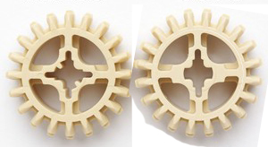

Hi there everyone! I would like to present to You my latest Lego Technic creation – a modification of Nico71 model: Small Black Sedan. My goal was to make it look more like iconic, late 80’ BMW e30 Coupe. Modifications involved: • remodeling the body, • fitting bigger wheels (49,5x20), • improving steering system, • changing power source for 12,6V custom battery pack. The most difficult and time consuming part was to design front grill – fitting too big front lights to it to look as most precise and neat as possible. I’m quiet satisfied with the outcome, I hope You will be to :) Steering system had to be modified because of this drawback: steering from servo motor is passed by 20z and 12z gears working in 90 degree alignment. Because of that the wheels were always turned a little bit for one side. To overcome this I’ve asked Efferman to design a new 20z gear with tooth’s alignment made like this: Part was printed by Shapeways and works really great. Thanks’ to that model always drives straight :) My second most important goal with this model was to check, if lego MOC is able to give fun on race track for RC models. To test it, I have used custom 10,8V Li-ION battery pack, which has maximum voltage of 12,6V at 100% charge. My Sbrick responded very well for this voltage, there were no burn’s or anything like that. Speed of the model is highly better compared to Lego 9V Li-ION battery pack. To maximize the effectiveness of the power unit, I’ve removed thermistor over-heating protection from Lego L-motor. With normal driving, temperature of the motor is on safe level. If You want to drive fast with Lego motors, I recommend to do this – it’s quiet easy operation :) You can check how the model performed on the race track In the video below. For me driving it was a great fun, but also a big challenge. It’s not so easy as it looks ;) But after some practice and tuning of the steering sensitivity in Sbrick Profile Designer, it gave a lot of fun and thrill. I think it would be even more attractive if there were couple models racing on the track – surely I would like to try it! So if You live in Warsaw - PM me – we could do some serious racing ;)

Hi Eff, is it possible to make a new version of 20z double bevel gear with tooth aligned like in the photo on right side? On the left standard lego 20z gear, on the right my photo-manipulation of needed gear;) It would be also great if you could design those wheelholders to fit in 56x34 mm Technic Racing Medium Wheel :) -
