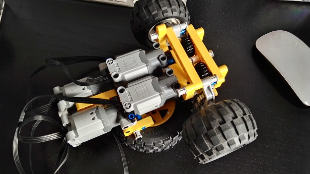

Full Album: http://imgur.com/a/YdL5x Specifics: 4x L Motors RWD (Geared Up 1.2x) Full Independent Suspensions 6x Shock Absorbers 2x AA Battery Box 2x V2 IR Receivers Frontal Led Lights Differential Weight: 1250g (with batteries) The Idea is to create an Heavy-Weight Buggy with good performances using no expensive pieces (Buggy Motors, SBrick..). The final speed is acceptable, the torque has some difficulties in uphill but for the plain is sufficient, and the maximum speed is reached quickly. I called it Fury Road because it reminds me so much the style of Mad Max vehicles. I know it's a little be "naked" but I like it in this way. I putted in it some lateral exhaust pipes, a little spoiler, a cabin and some lights to improve the aesthetics. I tried to put the IR receivers in a position that seems a big engine that comes out. Hope you like it! ;)

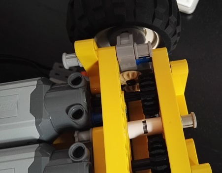

Hi Madoca, I was inspired by your creation and I'm trying to buy something similar. It's my first creation and I know I don't have the skill to buy something as complex as yours, but I think that trying to emulate your model (at least the chassis-engine-steering) will be a challening but very educational task. I know that L motors are not very powerful, and their speed is not the speed that I wold in my model. Then I'm trying to replicate the way you are connecting the 4 L motors, but gearing up them in a factor 1:1,6 instead as 1:1 like yours. Can you please judge the way I connected them? I used four 20-tooth gears connected directly to the L motors, giving transmission to four classical 12-tooth bevel gears, two for every wheel, like yours; creating then a gearing up of 12:20. Tires are maybe too little compared to the body (Lego technic 8437 Off Road Future Car) but they are the only I actually have. All advices are well accepted! Thank you! Detail 1:
