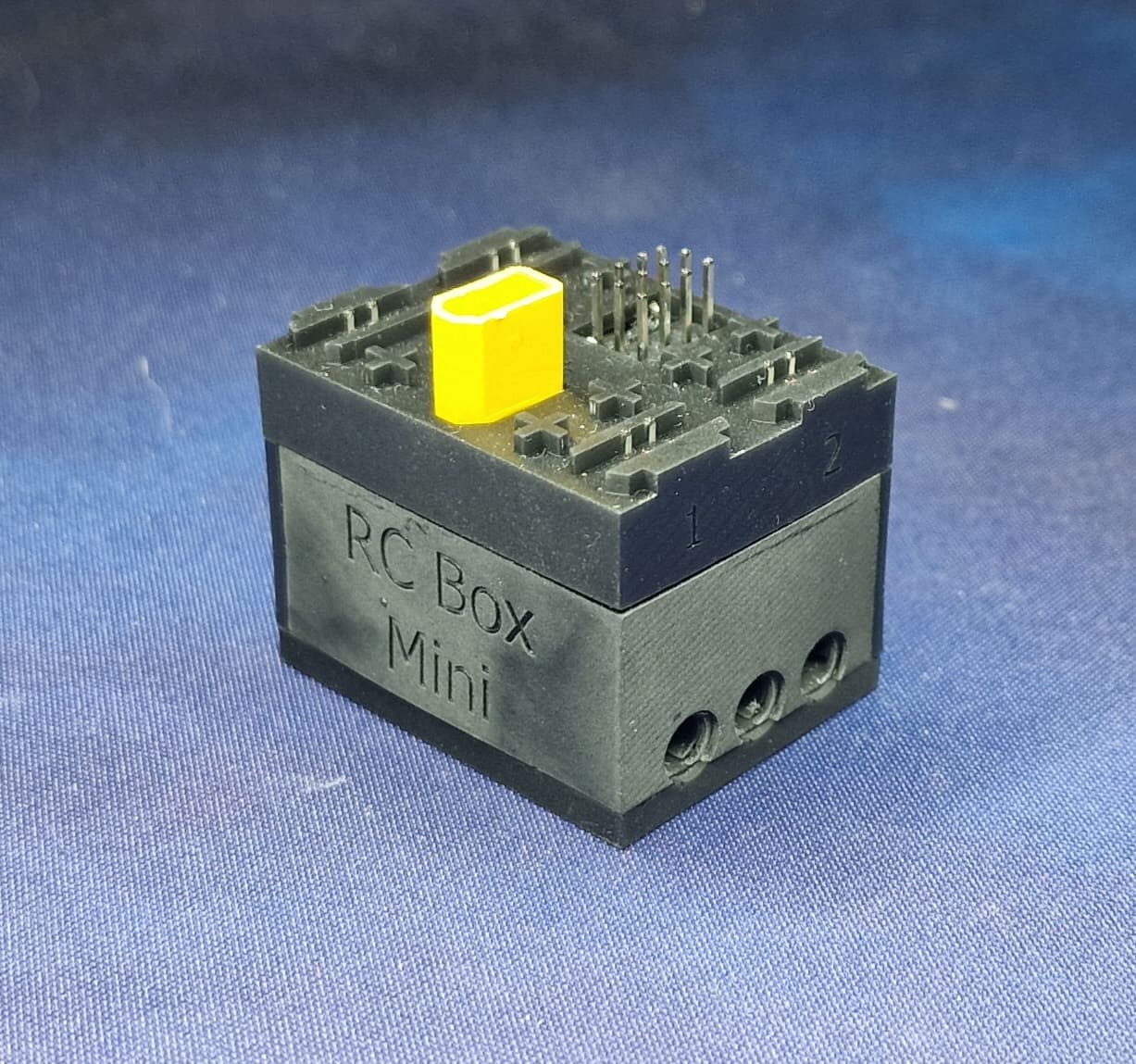

Hello technic friends,
I have some interesting new information about the RC Box. After I tested some different electronic speed controllers, I was able to get proportional servo control to work properly. So There will be an improved or fully working Version of the 10 Ch RC Box very soon, As well as the versions with different channel amounts.
  • 8 months later...

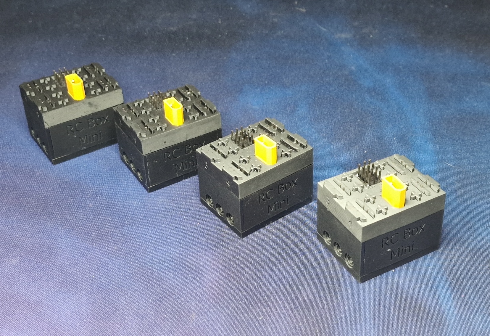

Hello Guys,
after 6 months without a single post, I want to share with you the progress I made on the RC Box. I now have 10+2 channels in the same box size as before. 10 normal Power functions ports (2 with finally working servo support) and 4 dual channels. Additionally there are two PWM channels which can be used to hook up non power functions components such as Geekservos, lighting modules (WIP) and Brushless motors (WIP) bringing the maximum motor count to twelve.
I made a new video which shows everything:
Best Regards
Adrian

Hello Guys,
thank you very much for the positive Feedback :)
16 hours ago, Krxlion said:
 I would love to try it out, but as you are planning further improvements, I guess we need to wait patiently. :D
Originally I planned to send out the first few test samples last year, but due to some tiny errors and assembling difficulties it had to delay that and only finished one Box for the video. I have to make some tiny adjustments and reorder the PCBs until I'm ready to sell the Handmade batches. But I really hope, that it won't take long. I'm going to be really busy in January, but I'm confident that I can start selling afterward. If you are really interested, just e-mail me at info@mistercreator.de.
The planned things like lighting Modules and Brushless Modules are independent of the Box and can be added separately if needed.
1. Is geek-servo not fully rotating +/- 90 degree in your case, or were you not fully rotating the knob during testing in your video?
Yes, the Servo did not rotate full 90 degrees, but I think this is only a setting in the transmitter regarding the servo signal and this should be fixed easily. I will take a look at that problem later
