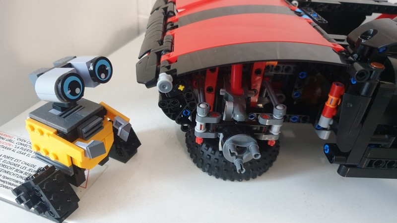

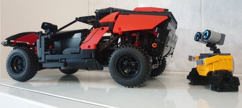

I decided to assemble this model from "old" parts - without new wheels, hubs, CV joints and small panels, as well as connectors 2393 and 72008. For the drive I took ordinary L-motors and a 4-channel remote control from China. During assembly, it turned out that the L-motors are shorter than Lego PU by 1 stud, but this did not lead to any problems. But the steering turned out to be quite bad - it was not possible to get a return to the center even once. I decided to put an ordinary servo motor - it easily gets up instead of an L-motor. But with him I got a problem with centering. In the end, I replaced 2 gray gears 94925 with 3 8-tooth 10928 + axle 3L. The result was a normal steering with a stable return to the center. Perhaps this will help you too.
Assembly of the model with new beams turned out to be interesting. I took the wheels and hubs from the Ford F-150. Thick CV joints replaced with old thin ones. Instead of 4x 2393, you can put 4х 65487 at the attachment points of the following parts. 72008 was replaced with an assembly of 2x41677 + 1x3713 + 1x32062. Small panels are replaced with other parts in place, depending on your imagination and taste. I left the differentials new, but with a "red" gear (12/28) - the Chinese L-motor has higher speeds and the machine drives quietly around the room.
