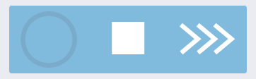

Hi there,
I have trouble coding with Pybricks (v3.2.2 (Pybricks Code v2.1.0) running under Chrome 110.0.5481.177 on MacOS 11.7.4). I can connect to my Control+ hub, but when I press the upload & run button, nothing happens. I then can only disconnect Bluetooth and reconnect to start over. But with the same result. I tried installing new Pybricks firmware onto the hub several times as well as connecting to the Powered UP app to reinstall the LEGO firmware. No change in behavior. Also I reinstalled the Pybricks browser extension several times.
Last year (using the then current Pybricks) I hat no such problems. Any idea, how I could solve this issue?
Thanks for your help!
Please gather as much information as you can on how to reproduce the problem and collect logs as described in https://github.com/pybricks/support/discussions/270. If none of the tips there (like turning off all other bluetooth devices) don't help work around the problem then find an existing issue at https://github.com/pybricks/support/issues that matches your problem or start a new issue if there isn't a matching one already and share as much information as you can so we can try to understand the problem better.
Expand
Last console-entry: "Downloading 796 bytes"
Only entry in the device-log: "Web Bluetooth Device Chooser initiating Bluetooth discovery session"
I did not find any existing issue matching my experience. Is there any way, I can roll back to last year's Pybricks? That worked fine for me.
Logging Bluetooth packets with Wireshark is really the best way to see what is going on.
Pybricks Code is open source. You can build from source and host on your own https server if you want to keep using an older version.
