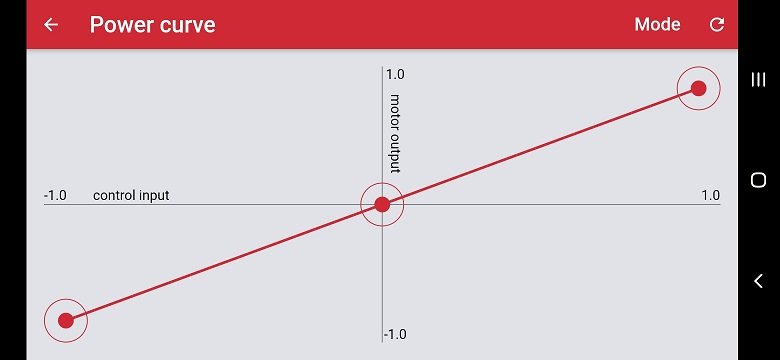

River Posted February 13, 2022 Posted February 13, 2022 Welp, I took the motors out so they have as close to zero load possible and tested each independently. I used the vertical slider control rather than joystick. There seems to be a LOT of dead movement - about 75% - before the motors actually turn while the Buwizz quietly screeches. Then the motors do incrementally turn, from zero to 100% in about 10% of stick movement. I have not touched the power curve, other than to confirm it is a straight line. There's also various levels of lag for each Buwizz output, up to about 2 seconds. Battery is fully charged if that helps Can anyone guess what I might be doing wrong? Quote
Zerobricks Posted February 14, 2022 Posted February 14, 2022 Default power durve setting is not straight, but the approximation of the exponential curve. BuWizz itself doen't make the noise, the noise is created by motors due to PWM modulation. Also make sure your ramp times are zero. If you still have issues, contact support and send a video. Quote
River Posted February 14, 2022 Posted February 14, 2022 (edited) Thank you for the reply. I'm afraid I have no idea how to adjust the ramp time in the Buwizz app, and as far as I can tell, the power curve is at least represented by a straight line in the app. I wish I could send a video of what's happening to me but the device I would use to record, is also the device running the Buwizz app. Edited February 14, 2022 by River Quote
Zerobricks Posted February 14, 2022 Posted February 14, 2022 Please contact support, so we can solve the issue. Quote
