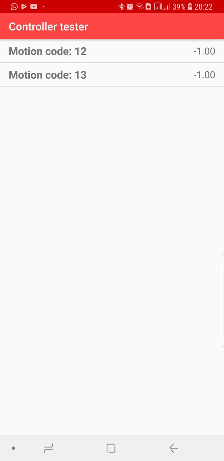

After a lot of testing I found a workaround for using the PS4 controller v2 (CUH-ZCT2E) with BrickController:
After pairing the controller, or after powering it up, don't touch any of the trigger buttons. If by mistake you touch any of them, power off the controller and power it up again (or un-pair and pair again). This way the button assigning procedure in BrickController can be finished without being disrupted by the permanent "-1" signals from the triggers (the trigger signals are only activated after first use of the triggers). The downside is that you can't use the triggers for motor control (which I would find useful for acceleration and braking).
I attached a screenshot of the controller tester with both disruptive trigger signals displayed. Exiting and terminating the app does not get rid of them.
This problem is tied to this controller type and is present on every android device I've tested it (Samsung Note 8 SM-N950F with Android 8.0, Samsung S6 edge with Android 7.0, Lenovo A3500-FL with Android 4.4.2).

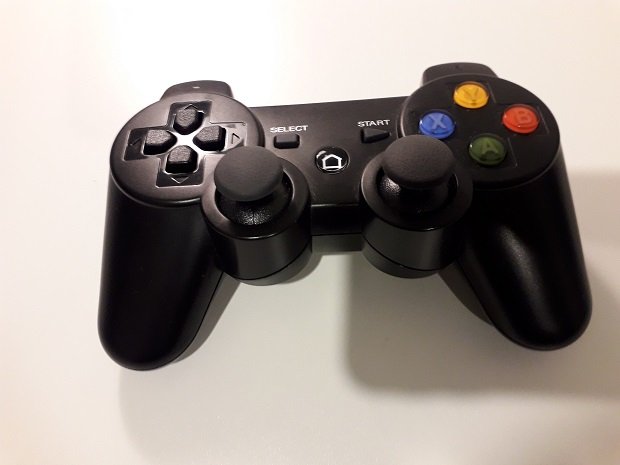

Hi There, I have one of these controllers (see image), when I first got it my phone was too old to use so I linked it to my samsung tablet instead.
I now have upgraded my phone so want to link my controller with my phone instead, but silly me I through out the instructions and can't work out how to make it search for a connection anymore.
Does anyone else use the same controller and know how to make it link to a new device.
Hi,
My controller looks very similar. You need to pair the controller in the Android settings not in the application. Also be aware that it has 4 modes and only one of them is working as a game controller. It can be switched by the home button on the controller.
Hope it helps. Happy playing! :)

I try to search for bluetooth devices from the phone but it can't find any devices, even though i have gotbthe controller switched on and on channel 1. Thought i must  need to do something else with the controller so my phone can find it.
I had a similar controller, there's a combination of buttons you need to press to switch the controller to discovery mode. If I recall correctly it was the central home button and one of the buttons with a letter, X or Y probably. You'll notice the discovery mode because the led on the controller starts to blink rapidly.
Cool, thanks, that did the trick. Wow I would have never figured that one out, thanks. (It was Home & Y, just in case someone else is having the same problem)

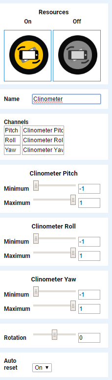

Hi, imurvai , I found that Dualschock 4controller(ps4) that supports motion detection via a three-axis gyroscope and three-axis accelerometer and vibration, these kind of motion detection gamepad can't properly use in ur app,
it seems like it will always has motion value, so I'cant select the button or joystick I want. And it motion value is not capable to steering or accelerate either.
Can U support Motion controller like PS4's Dualschock in next apk version? Maybe Sbrick source code can make it happen on gamepad.

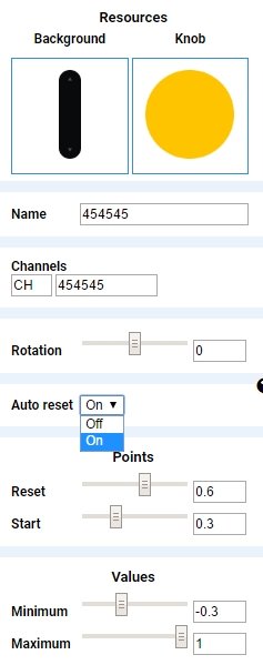

Furthermore, If that is possible, hope ur next version can support like sbrick profile designer already has.
like minimum output, auto reset, reset and start point, these are really useful to control cars like making a simulate idle speed etc.
and the toggle also can set the thing like that. I am wondering why we can't use toggle on Sbrick in ur app?
Thanks! hope these dream will come true :)

Thank you for the prompt reply.
But it's not Sbrick app, it's profile designer, I use it a lot because it will make more sense to make ur own definitions. Without the profile designer, the official app alone is too boring. I believe not many users knows this thing, because their official site is so confusing.... like where to login and how to get into social forum, and how to link to designer page. So far as I known, It seems has two different user database, so sign up Sbrick app account is not the same as sign up to Social Forum or Designer.
Check this: https://designer.sbrick.com/
Ah ha, I found that like joy vertical can't mapping to toggle buttons, some controller's like ps4 Dualschock4, R2 L2 is analog like joy stick, but I really don't know how to define these kind of value mapping to Toggle buttons. Maybe it is not a issue at all.
Also I can understand may be there is not a good source code to use on getting motion signal (3 Axials...and maybe it will combine two or three values at same time? ) It is a hard work, but if we can steering by turning gamepad, must be fantastic!
Hope you don't mind, I'm somewhat picky, but really hope this project going further :)
