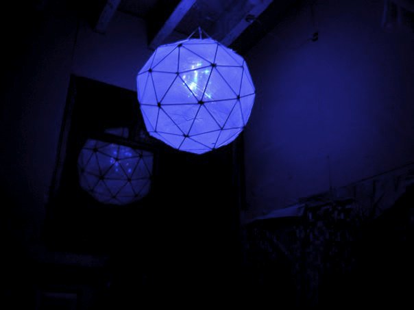

  1. reminds me of the time square ball i built for a friends new years eve party- (non lego)
