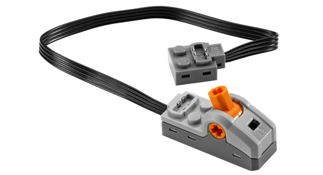

See my tank thread and look at the flashing lights mechanism for the rear end using a PF switch and an M motor. If you use the gear on the motor to turn two switches set at 180 degrees apart, that should fit your needs.- 42 replies

So how would I install it into the MOC to be able to make use of it remotely? I understand how I can do things by moving the switch by hand, but I don't understand why and how I would get a motor or mechanism to move the switch. 1. Regulating a pneumatic pump. - I think I understand why, but how would this work? 2. Opposite motor direction where multiple motors share the same power line. I get this, but that is just a 'change once' and leave it alone function. 3. Flashing lights I get this, but not sure how to implement it. Would you be able to share the why's and how's? Any other useful uses for this little device? Thanks :-)
Along with all the motors and lights and IR units and controllers recently purchased, I also have a PF switch. As some of you have read, my current (and first ever) MOC is a large tank with as many functions as I can think of. I'm struggling to find a use for the Switch. Can anyone give examples of where they have built or seen the PF switch out to good use and where I might find a use in a tank and its various mechanisms? Cheers. :-)
