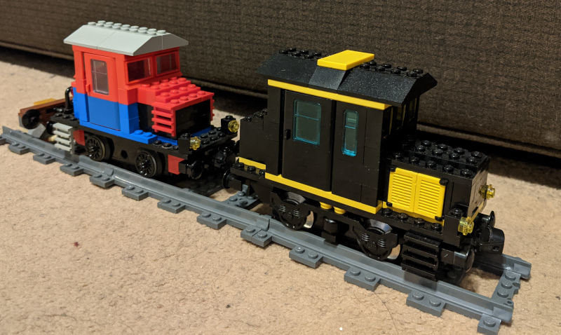

  12. I don't think there was an original one, either. The only stickers I can remember seeing used in 7777 were from the donor models (eg, '7760' for the maintenance vehicle on page 4) or from idea book 6000 (the circus scene). I've seen one third-party sticker sheet that consists of: * Stickers of a size to fit on train doors (company logo with '7777' underneath) * Smaller stickers with just '7777' * Two weight / water / coal capacity stickers of a size to suit weight bricks All in white. But no clown faces -- they're in the same vendor's 6000 sticker sheet.

  14. I experimented with green because I had a fair amount of it to hand - it works quite well replacing red in a lot of models (such as the big 7777 diesels, or the 7730 diesel shunter). And there are green train doors and 1x2x3 windows, which is helpful. It might have been considerably more challenging to try and replicate an 80s model in purple or lime green. There's a bit more freedom in 80s locomotives than coaches, because they often just need doors rather than doors and windows. I think there'd be even more freedom when recolouring blue-era models, because they tend to be built from generic bricks and don't require colour-limited doors and windows. I did try sketching the 7740 locomotive in LeoCAD to see if it could be done in 30575 colours. It looks possible: It might also work on 7750 or the 7777 Pacific, though I haven't tried to mock those up. Recolouring 7750 (or 7727, 7730) would be one way of avoiding the requirement for those black windows...
