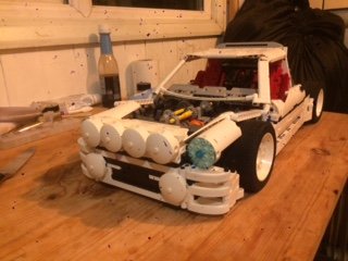

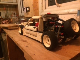

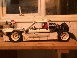

Ford RS200 MOC FINISHED?
MinusAndy replied to MinusAndy's topic in LEGO Technic, Mindstorms, Model Team and Scale Modeling
Hopefully these pics will work... -
After 2 years I have finally finished my MOC of the Ford RS 200. More info on the original can be found here: https://rallygroupbshrine.org/the-group-b-cars/rally-cars/ford-rs200/ I originally decided to build it a few years ago and Bought the 9:11 gt3 to learn how to use studless technic so I could have a go at building this. Its had countless rebuilds and tweaks and I'm finally happy with it, I will continue to mess about and improve it though. It originally had a lot more system on it but I've tried to evolve as much as I can out over time, Just because I really like the technic aesthetic. I've tried to build it in the spirit of the original so it has 2 shocks per wheel, Double wishbones front and rear, All unequal. A centre box with modular body panels. Opening rear clam shell, mid-engine with two prop-shafts connecting the front mounted gearbox. Spare wheel in the engine bay etc Features: 5+R gearbox in H pattern, mounted in the front as in the original. Adjustable Centre Diff with Fully open, around 35% closed and around 75% closed (this is based on how it feels spinning the wheels). operated from lever next to the gear lever. 4wd. Working Fake Engine with cam chain (the original is a belt but it looked weird with bands). Ackerman steering. Independent long travel suspension with unequal length wishbones and 2 shocks per wheel. Opening rear clam with locking lever behind the seat. Opening bonnet with realistic bonnet pop mechanism operated from the passenger footwell. Opening doors. Opening glove box. Here are some Pics. Better ones with an actual camera. and a video coming soon. Thanks to Grey Gear, Rudvidk and others for advice, without which this model would have been even more shonky than it is. I just spotted some bits of roll cage that need a squeeze! https://www.flickr.com/photos/186653841@N02/with/50075755636/ There are loads of build pics on here if anyone is interested in that sort of thing. Thanks for looking. Andy. I’m not really into pointy Italian cars and stuff like that. I’m a fan of ugly, purposeful stuff and there’s not many cars more ugly and purposeful than this ‘80’s group B rally monster. For 12 years it was the worlds fastest accelerating production car and I love that amid the cutting edge technology it also has a load of stuff raided from Fords Sierra parts bins. I’ve been thrashing away at this for a while. It’s my first Lego build since about 1998 so it’s taken a while to get to grips with studless building techniques. The front is now at a stage where I’m reasonably happy with it. Function wise it has working suspension with two shocks per wheel, as the original. It’s got a moving BDT engine with working cam chain. sequential 4 speed gearbox in the front, as the original. (Though the original wasn’t sequential I really wanted to build a rally style shifter) It also has 4wd with three diffs, (the centre diff is semi open using a modified clutch wheel.)Steering, opening doors, will have opening rear clamshell and probably a few decals. Hopefully I’ll get the rear clamshell built in the next couple of months and then I can turn my attentions to a huge A10 thunderbolt that I’ve been casually flirting with building for a while now.
