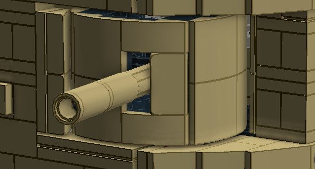

Exile Phoenix replied to SquirrelArmy's topic in LEGO Star Wars
Looking at the underside of the ship in LDD, you should be able to use a 1x1 plate, 1x2 slope, and 2x4 plate all in clear right in front of the 1x3 double slopes on the bottom to shift the stand one stud to provide better support for the center of gravity shift, a second identical support could go behind the 1x3 double slope to additionally anchor there (which only really helps if the center of gravity is currently at those 1x3 double slopes). For the additional TIEs, you could also look at trying to position a single TIE about to knock Vader for right after the Falcon arrives. Adds a little more dynamic and also potentially gives you more freedom on width -
