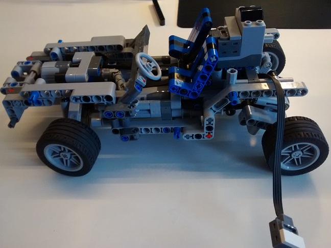

  6. Which u-joint do you mean? Is there a problem in the design somewhere? O wait, the universal joint? As stated in the original post, they actually hardly turn. The play in the universal joint is larger than the possible turn radius. If that werent the case, it could turn though... maybe i should replace it with some gears.
  7. Hi all, This is my first post here, I'm not sure if the way I shared my pics works well. I've built a small-scale RC car, based on the 43.2x22ZR tires. My goal was to create a car at that scale, and still have full RC and suspension. The minimum width is determined by the differential and the steering pieces I used. I wanted the back wheels to connect to the rear axle through that double bush, so pulling at the wheels wouldn't mess up the gears in the differential. I have small kids, so the car needs to be sturdy. The result is the work attached. More pics can be found in this album: http://imgur.com/a/dw8jx. The springs I used are a little too soft. Since the car is not finished, this is not yet a big problem for the live axle, but the front already doesn't bounce up all the way because of the weight and position of the servo. I think I'm going to have to replace the grey springs with yellow ones. The steering wheel turns with the servo, but because I used the Arocs-mechanism for steering (no rack), the servo only has to turn a little bit. And this little bit is almost completely lost in the play of the two universal joints. I'm usually quite bad at building bodywork. I think this car should be a mustang-type, because of the current shape of the front, and because I based the rear axle on a Mustang. I've left plenty of opportunities to connect the bodywork, and I plan on making it easily removable. I've yet to think about which of my battery boxes I will use, so that will have some impact on the bodywork as well. Any remarks are appreciated. Filip
