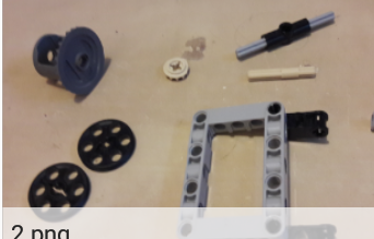

LegoTT Posted September 28, 2019 Posted September 28, 2019 Bricksafe>search>diff pop Sorry I can't do better right now. The key is to use the yellow 4L axe Quote
Attika Posted September 28, 2019 Author Posted September 28, 2019 4 minutes ago, LegoTT said: Bricksafe>search>diff pop Sorry I can't do better right now. The key is to use the yellow 4L axe I'll bring it in for you: Reaction: It is entirely irrelevant for a geometrical problem that occurs in my setup, not to mention it doesn't apply on the given width of the axle. For the future, upload the pics with original resolution. Bricksafe will reduce it to be suitable for this site. Geometrical anomalies as it is, usually get solved by great thinkers like @Didumos69 . Need your help here, Lord of Triangles! Quote
