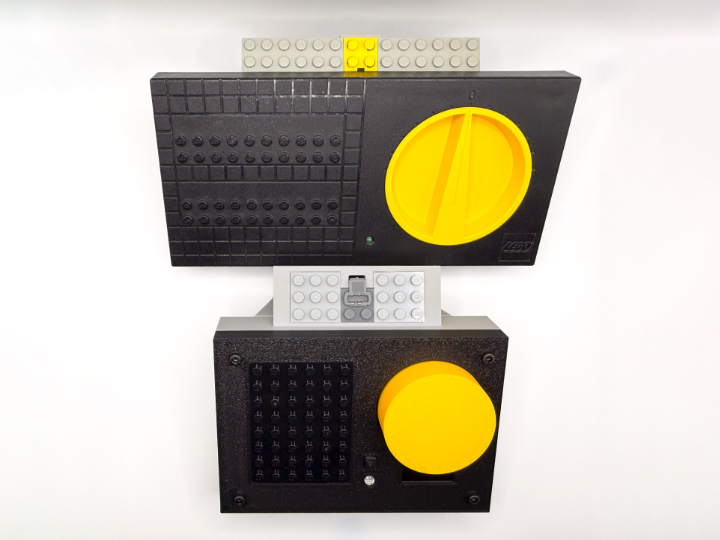

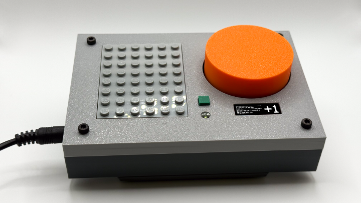

diegobaca Posted October 16, 2025 Posted October 16, 2025 (edited) I’m excited to share that Interface C is now available. It’s a modern take on the classic LEGO® 9V Train Controller (4548), designed to give builders precise speed control and versatility — perfect for powering Technic creations, Great Ball Contraptions, and custom motorized builds. Interface C with Dark Bluish Gray, Light Bluish Gray, and Orange - LEGO® Power Functions colorway. 🔧 What It Does Provides six-speed precision control — forward or reverse — with a smooth rotary dial. Connects directly to LEGO® Power Functions motors, letting you breathe new life into old builds. Remote control via web interface, allowing you to manage motors wirelessly over Wi-Fi. Fully compatible with Windows and Mac through the Interface C Utility for firmware updates and configuration. USB-C port for firmware flashing and diagnostics. 🛠️ How to Get It Interface C is available in multiple options depending on how hands-on you want to get: Full Kit A — includes the microcontroller. Full Kit B — without microcontroller, for those who already own an Arduino Nano ESP32. Fully Assembled Unit — ready to use out of the box. Each kit includes high-quality parts, assembly instructions, and access to digital resources — even STL files to 3D print your own housing. Learn more and get your kit at 👉 https://interface-c.com LEGO® 9V Train Controller (4548) compared to the Interface C with Light Bluish Gray, Black, and Yellow colorway. Edited January 25 by diegobaca Quote

Toastie Posted October 17, 2025 Posted October 17, 2025 16 hours ago, diegobaca said: Interface C Whoa!!! That's an announcement! So, Interface A had 6 outputs and 2 inputs. Interface B had 8 outputs and 8 inputs. Interface C has 1 output and no input? Seems to me more like a smart power supply rather than an interface? "Smart" as in providing Wi-Fi/BT/BLE/MTQQ/etc. connectivity and control (well, all that an ESP32 provides). This should also allow for control via home-integration/assistants. So yes, it is an interface! And very nicely done - it has a really appealing look. Congratulations on your achievements!!! Bringing such a device to the market is really something. With that USB port connected to the ESP32 hybrid controller inside (not only for diagnosis, but power-programming!), along with an X-channel USB switch, you can also orchestrate a nice X-channel Interface. Sensors can be hooked-up wirelessly. It will be a little pricey though - well interfaces A and B were sure as well! All the best, and thanks for sharing! Thorsten Quote

M_longer Posted October 18, 2025 Posted October 18, 2025 What's the advantage over old 9V controller, except wireless/wifi control? Quote

M_longer Posted October 19, 2025 Posted October 19, 2025 (edited) 19 hours ago, diegobaca said: you can plug a Power Functions motor directly into the device. Well the extension wire is better, becuase you can place the controller further from the motor. 19 hours ago, diegobaca said: which is becoming harder to find these days. Over 600 units available at Bricklink, not to mention local pages which sell LEGO. And average price is 19$. ANd can work with any 9-12V supply/ With $98 price range it's hard to sell your idea for BT controll for $78 Edited October 19, 2025 by M_longer Quote
diegobaca Posted October 19, 2025 Author Posted October 19, 2025 19 minutes ago, M_longer said: Well the extension wire is better, becuase you can place the controller further from the motor. Over 600 units available at Bricklink, not to mention local pages which sell LEGO. And average price is 19$. ANd can work with any 9-12V supply/ With $98 price range it's hard to sell your idea for BT controll for $78 I don’t think it’s better or worse—just different. It simply gives you the option to use the extension cord or not, since it supports both. Mine also works with any standard 9V power supply—it doesn’t require anything proprietary. Regarding stock, I live in the U.S., and there are only about 30 available right now. Half of those are priced above $50, so the “build your own kit” option ends up being comparable in cost. I’m not claiming my version is cheap or suggesting everyone should buy one—I’m just sharing a project I made and putting it out there for the community. There are also some other advantages: it has a screen that displays the speed value, it’s customizable, you can design and print your own case in any color, and it’s easy to modify or hack if you like to tinker. Quote

Toastie Posted October 19, 2025 Posted October 19, 2025 41 minutes ago, diegobaca said: I’m just sharing a project I made and putting it out there for the community. And I find that absolutely wonderful! And really appreciate this. This is not that common anymore. You put a lot of thoughts into your project - from the electronic design stage all the way through the customizable case! There are a couple of "things" (let's call them simply "things", not wishes, issues, or dreams; these are naturally diverse, every individual here and elsewhere has individual demands). For one, you are targeting PF and, with a conversion cable, 9V folks. PF and 9V is phased out since long. So folks get their supplies from the BL aftermarket - or from China. The latter is definitely cheaper. Once you take that route, some call The Dark Side (which to me is utter nonsense: The moment I can't get an original part anymore for every single device here in the house, I go China, believe me), you all of a sudden feel "free". At least this happened to me - today I can drill into any LEGO piece if I want to, because TLG did not make what I need, without getting nightmares or any bad feeling. It is ABS I am drilling into. At that point, the advantages of any newly developed third party device designed for LEGO stuff but targeting the LEGO aftermarket must be compelling. Otherwise, it will be just: Naa, can get this and that here and there for less. See, what I would do, if I required a nicely controllable 9V DC power supply? I'd go with a modern Chinese lab power supply, 0 - 12 V, 0 - 5 or 10 or more amps. The current limitation is good for testing purposes or simply "early motor burn out protection". 9V (train) regulators don't need proprietary power supplies, this is one of the many TLG myths. Or lies. Anyone in the correct range will do. The 9V controller is internally nicely protected, nothing much can happen there. No, the usual stuff won't work, as Pete Venkman said in Ghostbusters, when he tried to get in touch with hat lady-ghost in the library. Not the PF terminal, not the amperage, not the power supply. Your approach has this powerful extra, though, a microcontroller. ESPs are crazy. And dead cheap if you skip the Arduino part. With WiFi, BL, BLE, easily connected to an (OLED) display, it has many inputs. Which makes a total difference. The thing is: a) How to use it for b) what purposes. Do GBC folks need that? I don't know. Do train folks require that? Hmm, maybe? Do Technic (machines) need that? I think so. But then you need inputs. You said you want to do loops per programming. Well, there are not that may static/constant loops, there are controlled loops. I have no l clue how to get sensors into your project, but it would make such a difference: A smart >power supply<. Not a smart brick, they are out there: A power supply. I, for one, like the display. Others will tell you: I can still "read" a dial (which is true, I can as well, but). I like the wireless stuff. Others will tell you: Go to a show and BOOM, you can hear Radio Gaga, but not reliably control your contraption. So what, I don't do shows, I have fun@home. Hmm, as said, I love your project. I find it absolutely original, fun, and appealing. See, I make my own stuff, virtually >nobody< here is interested in, except a handful of total nerds (= wonderful people), which share the notion of "just sharing a project I made and putting it out there for the community". These are your words. And THAT is totally cool and what drives me. I will closely follow what you come up with! Keep on rolling!!! All the best Thorsten Quote
BatteryPoweredBricks Posted October 19, 2025 Posted October 19, 2025 I'll go on record and say how awesome I think this project is. It's not for everyone, but nothing in life is ever for everyone. Here are some positive things I see: For GBC builders the higher output current will be great! I'll do some hands on testing once mine arrives but I would estimate the Interface C could take the place of at least two 9v train controllers and should provide a more steady voltage. Same goes for train builders. Need more than two 9v train motors? You'll need more than one Lego train regulator anyway or some other custom solution. Having a PF plug output is great! Official Lego extension cables can get expensive and they won't be needed here at all. You can buy PF plugs cheaply online along with some silicon insulated wire and make any cable length you desire. I have yet to see a third party 9v to PF conversion cable and I doubt any company outside of FxBricks will be making aftermarket 9v cables. I'm still an advocate for a cheaper "dumb" version but I'm sure there are some folks out there that could find creative solutions for the app control or implement their own additions to the code on the micro-controller. I love the aesthetics of the Interface C, it's very "Lego"! I could see this inspiring many more projects / devices in the Lego community. The stl files are freely available so if someone wanted to make their own motor controller they already have a design for an awesome enclosure to put it in. Lastly... it's fun! I've been itching for a fun electronics project to build. At this point I would pay for the building experience even if I never planned on using it 😅 Quote
