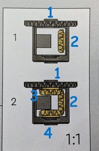

Govo8488 Posted May 18 Posted May 18 Hi to all!!!I noticed a big problem in the part on page 87 of the beige gears. After having also assembled all the subsequent part of the engine with the cylinders I tried to move the engine shaft and I noticed that a wheel did not always move with the engine or at least it gave this impression. Gear 1 is rotated directly by the engine, through 2 it simply moves the wheels. But gear 2 must not rotate on itself, otherwise the wheels remain still. However, gear 2 is a round pin on a cross hole so depending on the friction it sometimes turns. In my opinion, 2 should be blocked. Opinions? Quote
Auroralampinen Posted May 18 Author Posted May 18 19 minutes ago, Govo8488 said: Hi to all!!!I noticed a big problem in the part on page 87 of the beige gears. After having also assembled all the subsequent part of the engine with the cylinders I tried to move the engine shaft and I noticed that a wheel did not always move with the engine or at least it gave this impression. Gear 1 is rotated directly by the engine, through 2 it simply moves the wheels. But gear 2 must not rotate on itself, otherwise the wheels remain still. However, gear 2 is a round pin on a cross hole so depending on the friction it sometimes turns. In my opinion, 2 should be blocked. Opinions? Well, thats how the differential works. If one wheel is off the ground, it will spin freely while the other stay still. And differential helps with steering Here is helpfull video to show, how differential works:). Quote
pleegwat Posted May 18 Posted May 18 I've always been a fan of this classic video on differentials. Quote
Govo8488 Posted May 18 Posted May 18 1 hour ago, Auroralampinen said: Well, thats how the differential works. If one wheel is off the ground, it will spin freely while the other stay still. And differential helps with steering Here is helpfull video to show, how differential works:). Thanks....now i undestand!!! Quote
