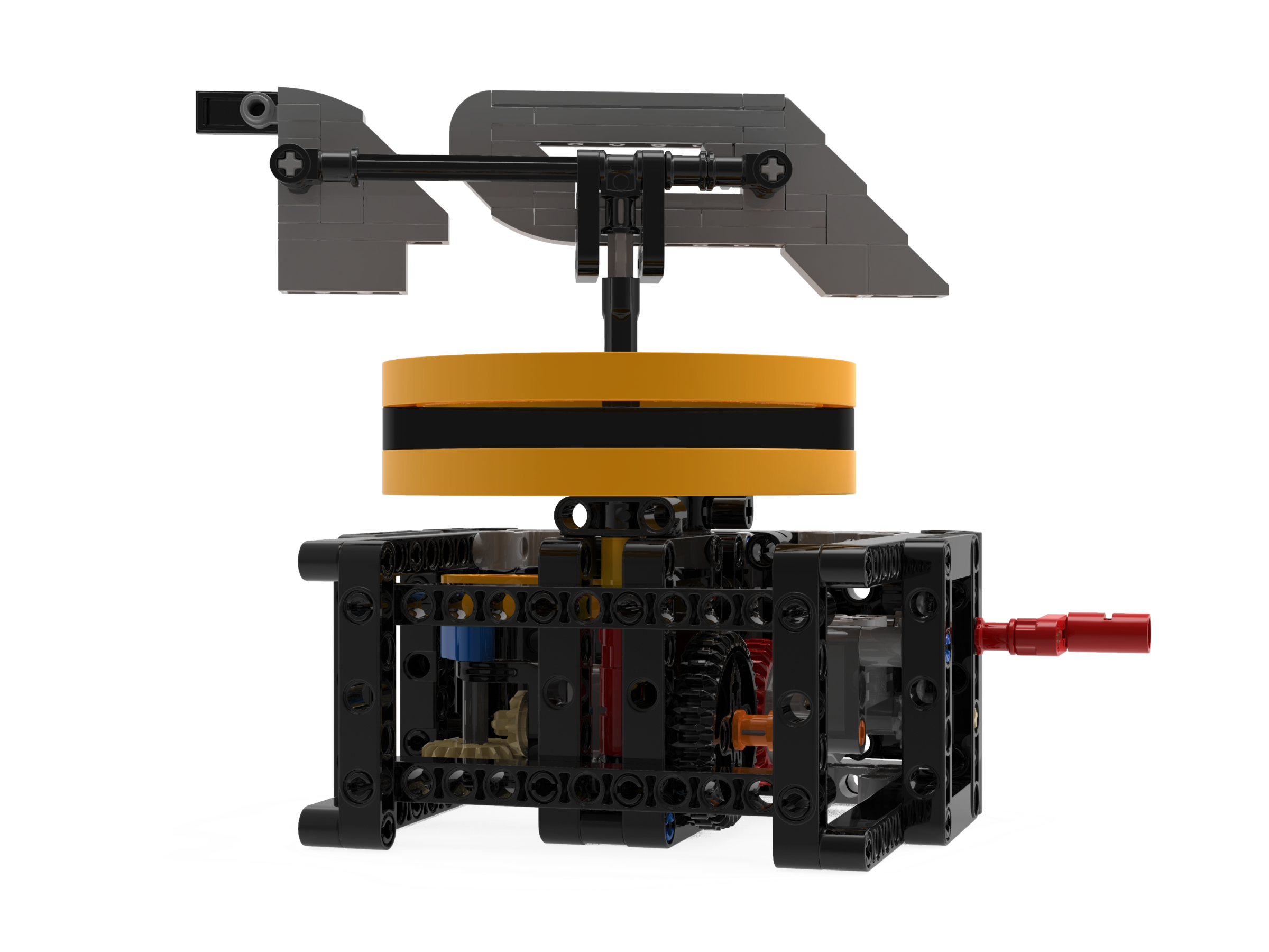

R0Sch Posted July 11, 2024 Posted July 11, 2024 Here's my reverse engineered GWP. Probably 99% accurate: 5008946.io And the mechanism: Quote
Zerobricks Posted July 11, 2024 Posted July 11, 2024 (edited) 34 minutes ago, R0Sch said: Here's my reverse engineered GWP. Probably 99% accurate: 5008946.io And the mechanism: Â You must be missing something... Spinning the handle in your model will do nothing, it will just spin the opposite side of the differential with a 4L axle with stop, which is totally loose. Edited July 11, 2024 by Zerobricks Quote
R0Sch Posted July 11, 2024 Posted July 11, 2024 14 minutes ago, Zerobricks said: You must be missing something... Spinning the handle in your model will do nothing, it will just spin the opposite side of the differential with a 4L axle with stop, which is totally loose. Yes, you are right. Forgot to fix that end of the diff. to the frame. Quote
Stereo Posted July 11, 2024 Posted July 11, 2024 If I understand the geartrain right, it just waves the P1 and circles back and forth about 60 degrees? And overall 4.28 reduction in gears, so about 4 cranks to fully go back and forth once. Quote
Kostq Posted July 12, 2024 Posted July 12, 2024 (edited) So if I read correctly - this whole contraption does what a home fan does - swivel/swing/turn left to right and back? Any mechanical reason for the diff to be there? Or the Orange friciton pin? Haven't had a coffee yet, my brain hurts looking at this thing. Edited July 12, 2024 by Kostq Quote
