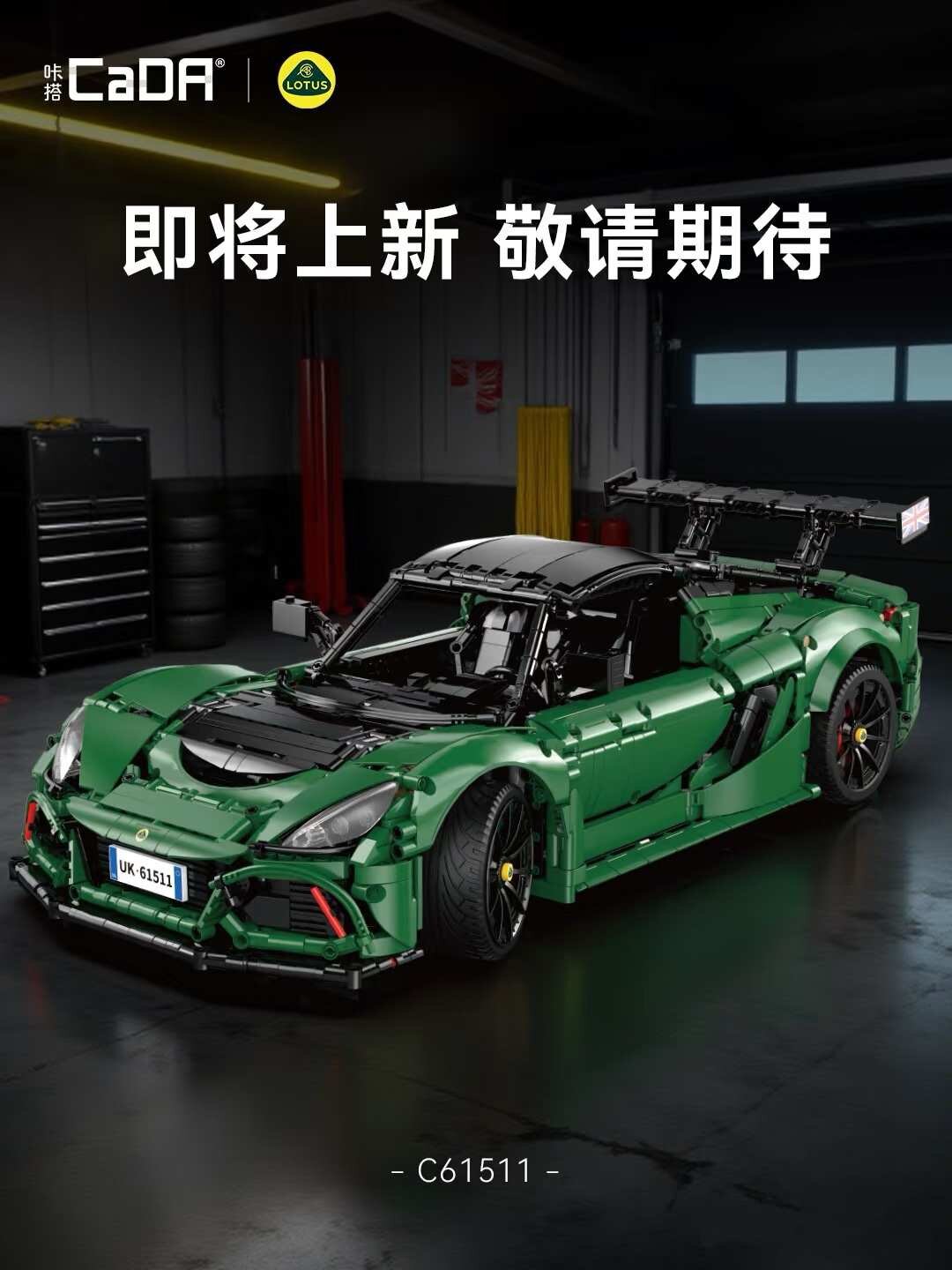

Chili Posted August 7 Posted August 7 (edited) CaDA will release 2 licensed sets C61511- Lotus Exige Cup 430 C64051- Suzuki Hayabusa Edited August 7 by Chili Quote
R0Sch Posted August 7 Posted August 7 Nice find! Interesting color for the Lotus, if it's 1:8, I will buy it for sure. Can't wait for the Hayabusa! I absolutely loved the Katana (see my review in earlier post) and as a motorcyclist a must have. Quote

blondasek Posted August 8 Posted August 8 @R0Sch it seems that Lotus is ~25 studs wide. So unfortunately not 1:8. @Bartybum yes and no. Cada still has massive issues with quality (like I wrote, replacing so many parts in Military Crane is a big deal) or their parts and they are closing the gap in price difference. I would say I am more "concern" about new Mattel Hot Wheels cars as they are not only gorgeous but also the quality is very good. I know that as I did buy Mercedes 300 SL. Let's see what future brings us :) Quote
