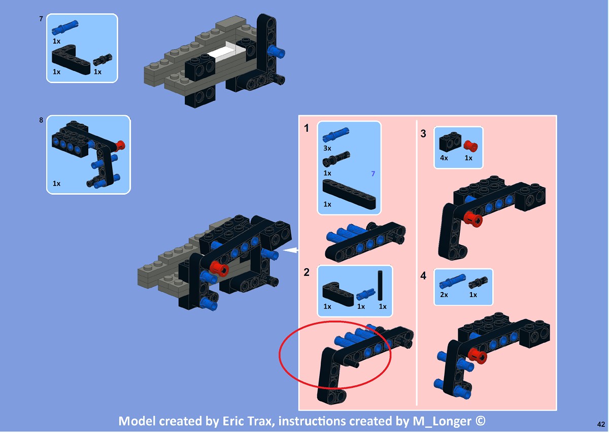

Ahm-crew Posted March 6, 2023 Posted March 6, 2023 (edited) At this moment I'm building CADA 61051 - CLAAS Telehandler by @eric trax First of all I would like to thank Eric for such beautiful model and very hard work! That kind of collaboration between designers and companies like CADA delivering more and more great sets to allow everybody to enjoy building anp playing with detalized models. But I've found flav in design. According to instructions on step A100 you need to connect one lower side of telehandler to its base. And there is a diagonal beam (7-size) which need to be perfectly fitted above motor. But when I tried to connect them I've found it impossible without damaging black 4x axle. That's because beam itself fits lower than motor and there is no space between them. I've checked previous steps in instruction to find my mistakes, but everything built correctly. On the photo you can see how much space is sufficient to use 4x axle (I insert long blue pin instead). Beam already sitting at the top of motor. Could anyone explain to me, what I did wrong and how you overcame this problem correctly? Edited March 6, 2023 by Ahm-crew Quote
eric trax Posted March 6, 2023 Posted March 6, 2023 (edited) 3 hours ago, Ahm-crew said: But when I tried to connect them I've found it impossible without damaging black 4x axle. That's because beam itself fits lower than motor and there is no space between them. I've checked previous steps in instruction to find my mistakes, but everything built correctly. Hi! This is one of the CADA changes in my first model for them. In the original Scorpion, instead of axle 4, I used Bar 3 (lego number 87994) which allows you to connect the elements you indicated in the picture. The upper liftarm is also moved further up due to the shape of the CADA drive motor. Here is the page from the original building instruction: Edited March 6, 2023 by eric trax Quote
Ahm-crew Posted March 7, 2023 Posted March 7, 2023 Thank you @eric trax ! That make sense. P.S. Case tractor and Liebherr dump truck are waiting for their turn to build. Looking forward for your 4th model! Quote

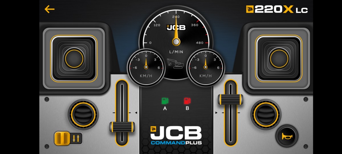

eric trax Posted March 11, 2023 Posted March 11, 2023 (edited) On 3/7/2023 at 12:38 PM, LvdH said: I think some will appreciate this one. Upcoming model from CaDA, designed by Eric Trax. I hope so I did my best to make this model surprise everyone. On 3/7/2023 at 4:18 PM, brunojj1 said: You are right about the panels! @efferman has found additional use for the spared 11x5 frames too - e.g. you can lock gears inside a rack and prevent them sliding out or mix the halfs of a 11x5 with a 7x5 frame for whatever special purpose. Actually there are 2x batteriy boxes (!) controlled by an app. I didn´t know about this development and I´m curious about the capabilities and new possibilities. Yes you are right. The model has two battery boxes and seven motors. If someone doesn't like controlling the application, they don't have to worry. The set will also come with a physical RC remote control which I am as proud of as the model. Below is the look of the excavator control application in better quality. On 3/10/2023 at 11:39 AM, brunojj1 said: Why would you wanna doubt it? I think it´s obvious, after all we´re not dealing here with scum like Mould King and consorts. I still can't believe that people think only LEGO can get official licenses. CADA is entering this market very aggressively. JCB is a very demanding licensing provider and they don't give it to every toy. You can take my word for it. It was very demanding even for me. One hint I can tell you is that the excavator has a new part that @SaperPL and I designed especially for this set and many Technic AFOLs will love it as soon as they see it. If anyone doubts what I am saying about licenses, below is another page from the cataloge <mic drop>. One of these models may remind you of what I have built before. Edited March 11, 2023 by eric trax Quote
