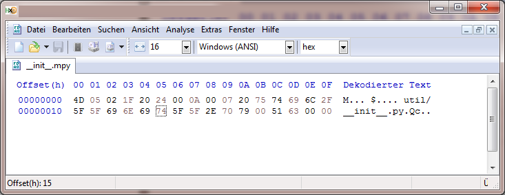

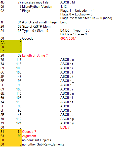

On 10/21/2022 at 11:30 AM, Pybricks said:
We've figured it out -- we've been doing this for a while.
Using their improved file format of compiled programs,
Hello,
I tried to find out how mpy compiling is working but failed.
What for  example would mean :
What I (think to) get till now :
@Pybricks : what is wrong im my understanding ?
Jo
Hi @BrickTronic - compiling programs is not Pybricks-specific. It’s the same as all MicroPython boards. Pybricks “just” adds all the code to make MicroPython run on LEGO hubs.
Most of our users don’t have to know all the details, but if you’re curious, you can learn more about the MPY format in the MicroPython documentation and their source code: https://docs.micropython.org/en/latest/reference/mpyfiles.html#binary-encoding-of-mpy-files
