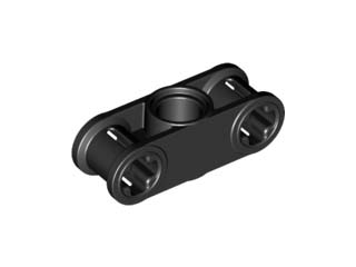

sonpham510 Posted February 15, 2021 Posted February 15, 2021 axle 3 in gear 36 slips out after a while. Is there any way to fix it. thank you Quote

Jurss Posted February 16, 2021 Posted February 16, 2021 23 hours ago, sonpham510 said: axle 3 in gear 36 slips out after a while Haven't driven so long Only option coming to my mind is to use this That pin already has smaller friction (as I have notoced), and with Your driving it will soon become frictionless anyway. Quote
sonpham510 Posted February 18, 2021 Posted February 18, 2021 What do you think if using axle 2 ? On 2/16/2021 at 9:12 PM, Jurss said: Haven't driven so long Only option coming to my mind is to use this That pin already has smaller friction (as I have notoced), and with Your driving it will soon become frictionless anyway. What do you think if using axle 2 ? Quote
Jurss Posted February 18, 2021 Posted February 18, 2021 It will then also slip out. But most critical could be, that other end of axle wont be "fixed", that large gear can lean on some side or something. Quote
Zerobricks Posted February 18, 2021 Posted February 18, 2021 Regarding axle slippage. A somple 1x3 tile held by 2 half pins covering the axle should do the job. Quote
sonpham510 Posted February 19, 2021 Posted February 19, 2021 18 hours ago, Zerobricks said: Regarding axle slippage. A somple 1x3 tile held by 2 half pins covering the axle should do the job. Is this part Quote
Jurss Posted February 19, 2021 Posted February 19, 2021 16 minutes ago, sonpham510 said: Is this part ?! Quote
sonpham510 Posted February 19, 2021 Posted February 19, 2021 You mean there must be a lego code 32184 Quote
Zerobricks Posted February 19, 2021 Posted February 19, 2021 2 hours ago, sonpham510 said: Is this part No, 1x3 tile: https://www.bricklink.com/v2/catalog/catalogitem.page?P=63864#T=C Held by 2 half-pins: https://www.bricklink.com/v2/catalog/catalogitem.page?P=4274&name=Technic, Pin 1/2&category=[Technic, Pin]#T=C Quote
